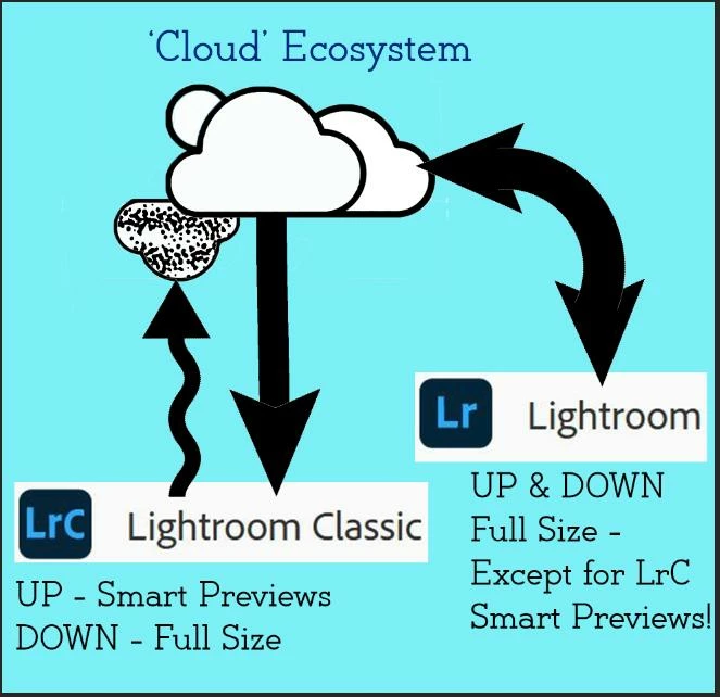

"while the raw photos are in the Cloud and not the hard drive of the Mac"
If Lr-Classic has sync turned 'on'  then all original Cloud files WILL be downloaded to the Mac hard-drive!- Automatically. So you will need space available.
Only when LrC sync is turned 'on' will edits sync "identical" LrC<>Lr.
