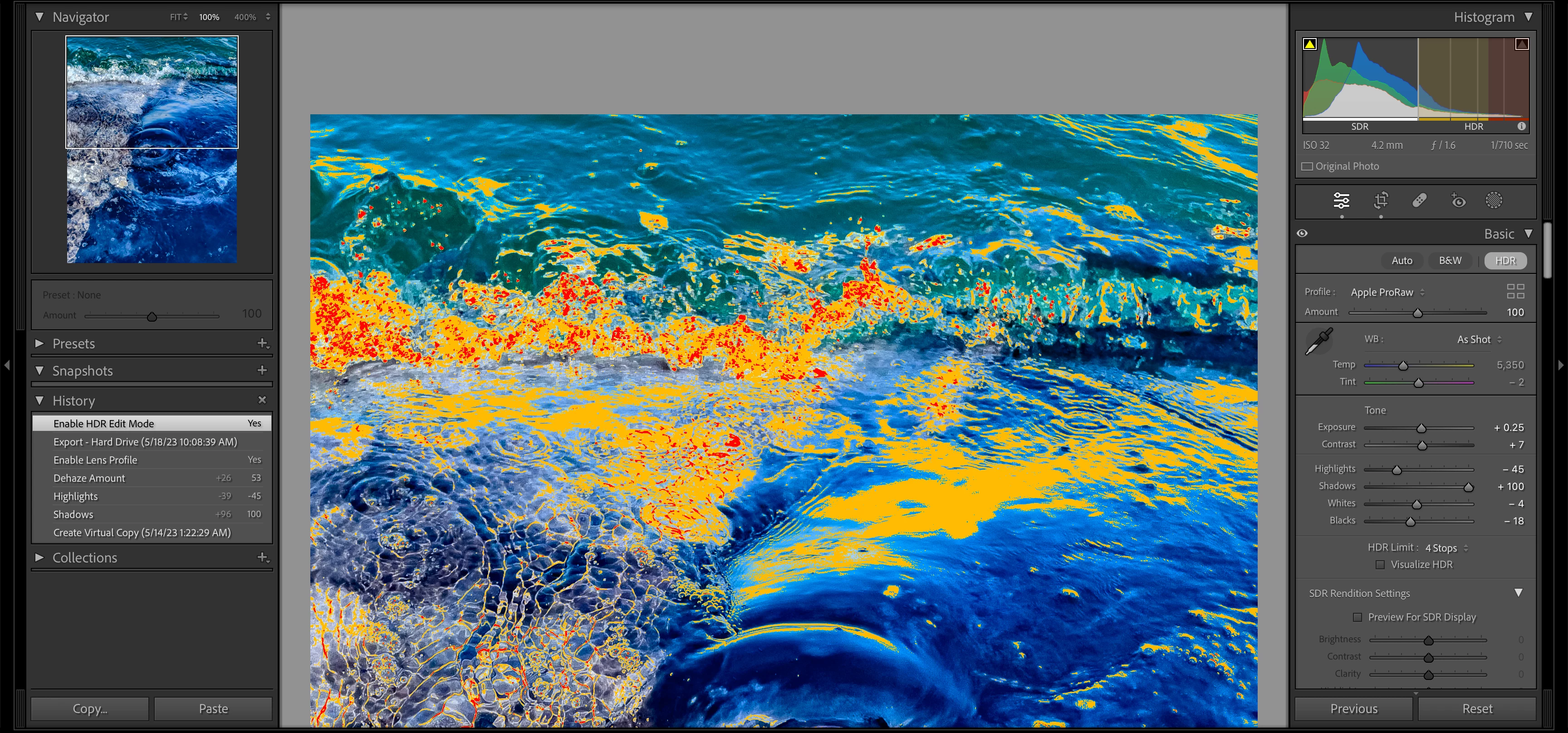

I've noticed the button in the develop panel in the new version but to be perfectly honest with you I don't even truly understand exactly what is going on as I haven't looked into HDR monitors. Are these newer monitors simply capable of displaying a wider dynamic range now, and thus lightroom in HDR edit mode gives you the option to push your edit further to take advantage of the additional clicks of brightness you can play within before you clip? Sorry if I am betraying my ignorance, though I suspect many others are also still kind of clueless.
Please see attached screenshots. I'm on a new macbook pro and therefore I think I have the hardware to utilize this new feature. I see that once I enable HDR, without adjusting any sliders, it appears that in develop mode the image appears much more contrasty than before, but it seems that at least in this one image that I just tried it on, the highlights are clipping a bit from the outset. I'm a total newb to HDR monitors/workflows so  I would love to read up on it if you can recommend an authorative source of information. Thank you. (Up to this point HDR to me was just that thing that my 5dmkiii could do where it could blend a few exposures into one image.) I'd love to read up on it, play around and join a discussion if you can point to some quality information on the topic. Thanks.
