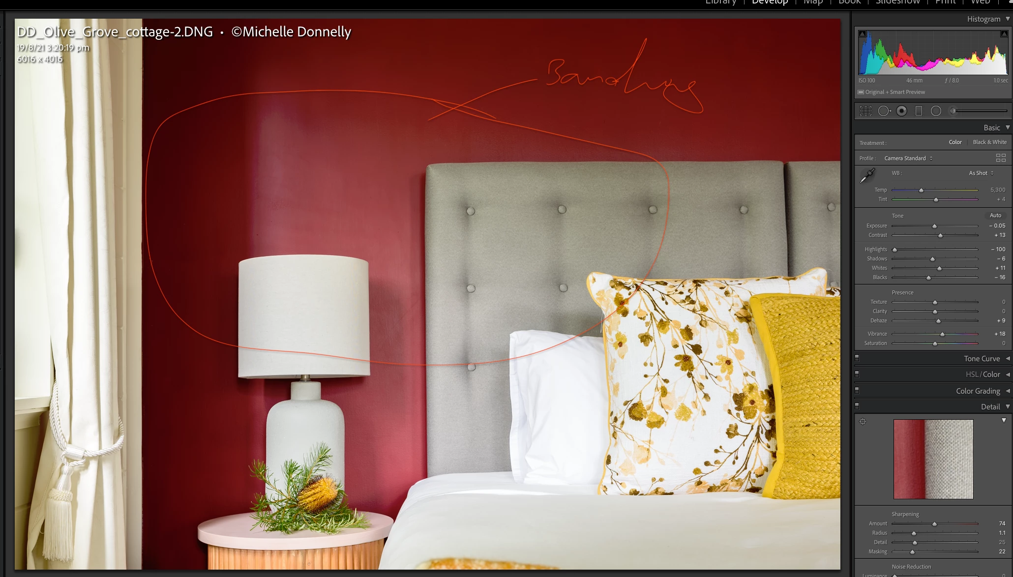

Terrible Banding on images when exporting for Lightroom and PS to Jpeg
Hi all, I am currently experiencing really bad bandin in images when exporting as a jpeg from both Lightroom and PS, I have tried just about everything I can think of but I am not expert but have some experience. The images look fine in PS and Lightroom before I export, I have changed colour space, image quality, checked monitor calibration but can't seem to work out what is going wrong..
I have will upload the jpeg files and screenshots of teh images in both LR & PS any advice most appreciated.

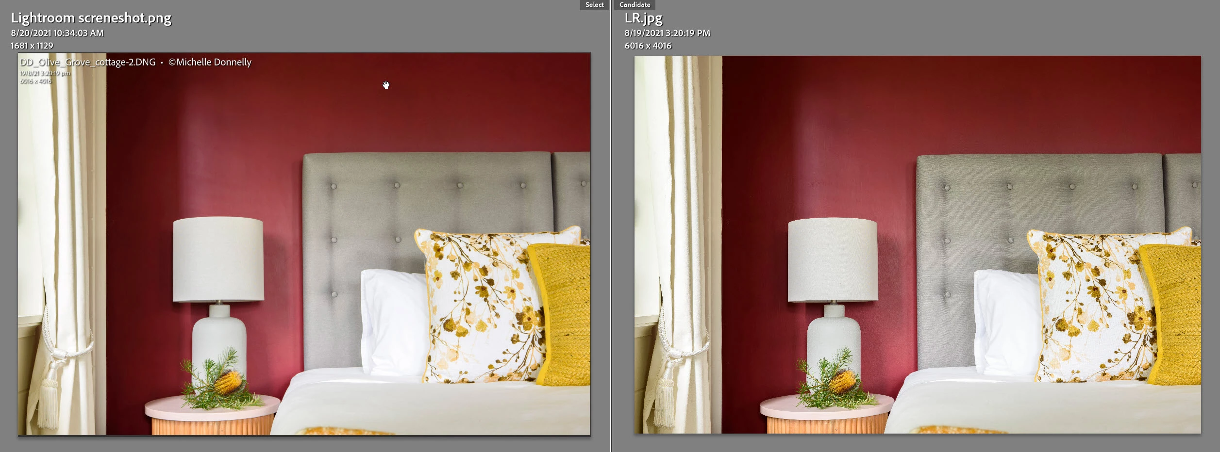

Do yourself (and me) a favor by downloading the above posted full size JPEG export files LR.jpg (LR export) and PS.jpg (PS export). When viewed in PS, LrC Develop module, XnView and FastStone Image Viewer no banding is observed at any Zoom setting. What do you see?

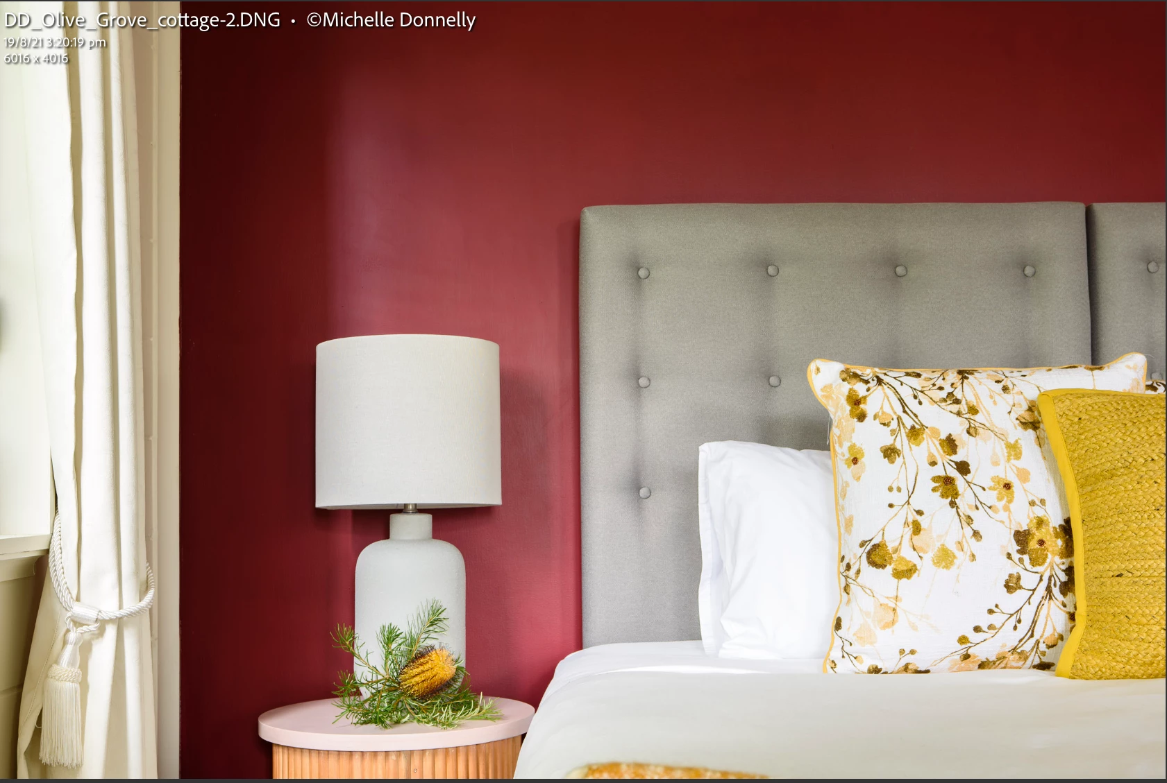

After a brief memory jog concerning banding in LrC Library previews I was able to replicate the issue. Please see the below post in the Photoshop Family forum where I reported a change was made to the Library module Preview Zoom interpolation in LrC 9.3. Please add your comments at that post to help get Adobe's attention.
The issue is most apparent when the Zoom setting is 33% or less. In the below screenshot the Zoom was set to 19.4% for the LR.jpg file. The banding issue is due to Adobe changing from Bicubic interpolation to the less accurate Nearest Neighbor interpolation for the Library previews. The Develop module does not exhibit the issue and other photo editors or viewers should not exhibit any banding.

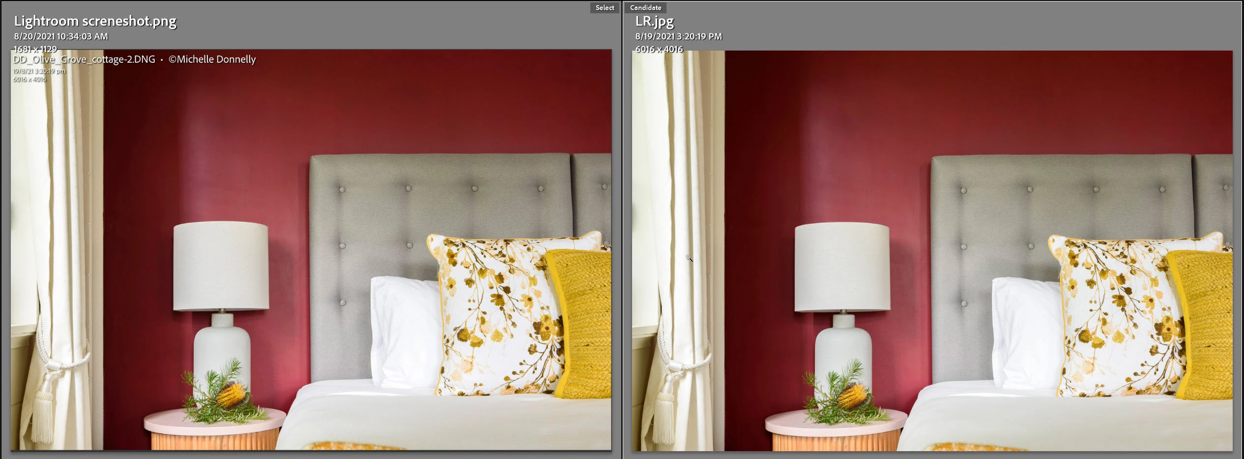

I'm not seeing any banding in the LR.jpg or PS.jpg image files (see below Compare view). What application are you using to view the JPEG export files? I'm viewing them inside LrC and PS with no banding observed.

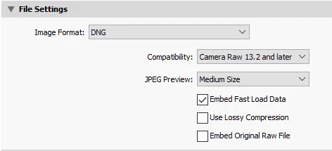

Try turning OFF 'Use Graphics Processor' in Edit> Preferences>Performance and close and restart LrC. Then view the LR.jpg or PS.jpg image files inside LrC. Import them if you haven't already done so. If the banding is still present Export the raw file with your settings that exhibit the issue to DNG file format as shown below and post the DNG file to a file sharing website such as Dropbox. This will allow viewing the original raw file on our systems with your settings.
