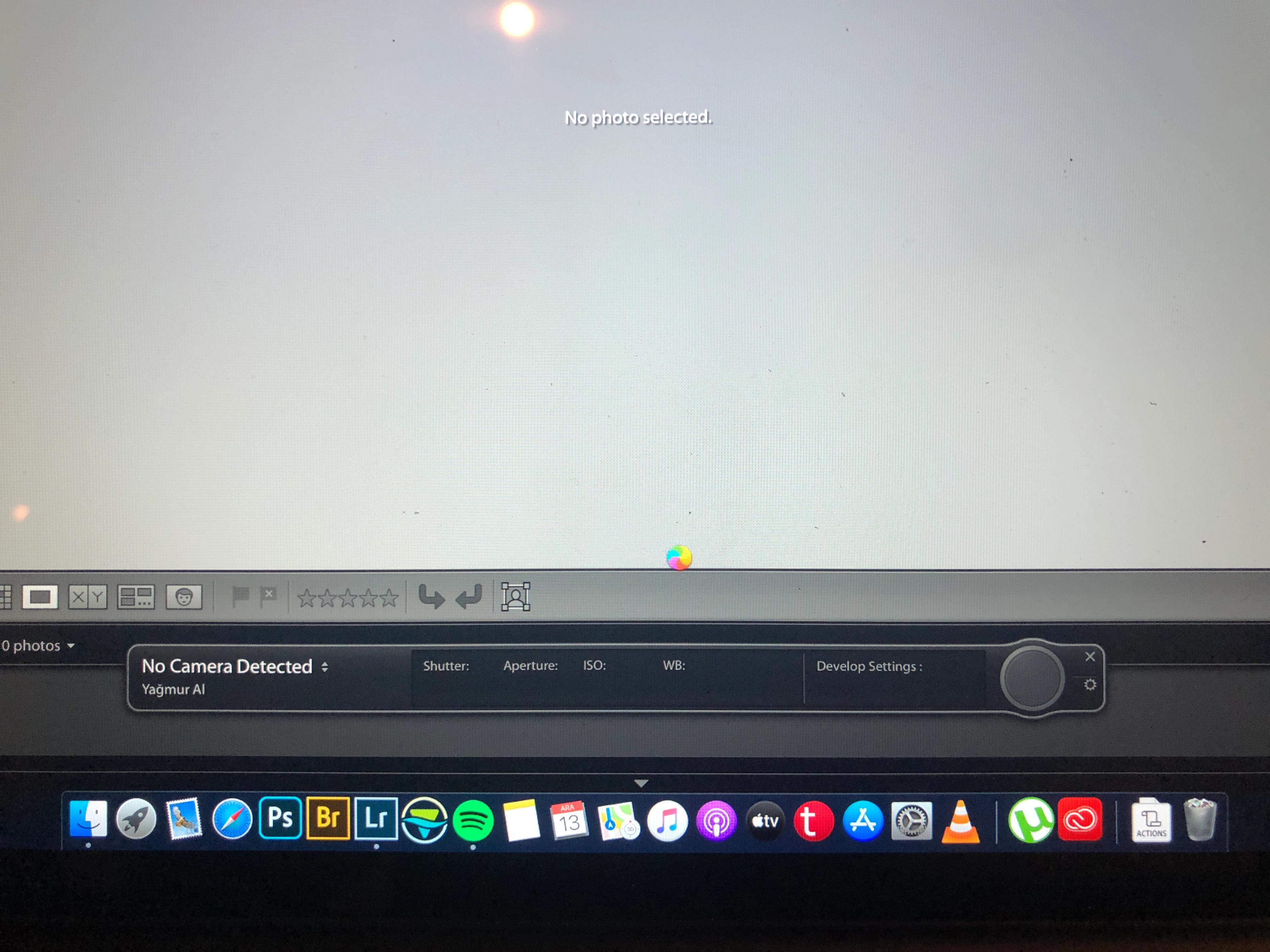

Hi, i have upgraded my iMac 15.10.1 to 15.10.2 and updated lightroom lastest version  and if i connect my canon camera to usb for tethering, i can't see my camera on the acquisition software (Lightroom )but if i go to see in the system information i can see it.
December 13, 2019
