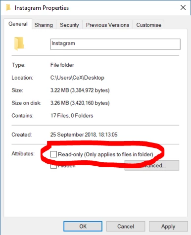

I have a new win10 computer.  I have been able to export files.  Went on a trip for a week.  Came back today I cannot export any files.  I get a window titled: Some export operations were not performed.  The file could not be written.
Have searched for answers.  Cannot find anything that solves the problem.  One place said clear my cache.  It is empty.  Tried uninstalling and reinstalling Lr.  Did not make a difference.
Help please.
Thank you,
Tom
    Correct answer ManiacJoe
    Using Windows File Explorer, check the security permissions on the folder you are trying to write to.
    At a minimum, your account needs READ and WRITE access.
    Sometimes you need give those privileges to the "everyone" group.

    Thank you Joe, it was to my Desktop and it was set to Read Only.  Big Smiley Face!

    Where are you exporting images to? Is the location you're exporting to writeable?
