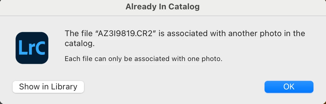

Hi everyone - need a helping hand here.
While processing a bunch of digitized negatives (with a D850 so am working with NEF files) using Negative Lab Pro in LR, I discovered a few that weren't behaving well when converting to positives so I went back and re-imported a few images from the camera.  I put them into a separate folder in LR and just finished up the first.  The conversion worked well, so I exported to the separate folder.
Wanting to get those corrected files moved into my original file structure, I renamed (using Windows Explorer) the "bad" NEF in the file structure, then, inside LR, moved the "good" image in LR from the separate folder to my original folder.  Checking (again, in Windows Explorer) that the "good" NEF file was there (it is), I clicked on the Folder in LR and noticed that I have the ! in the upper right of the image.  Having learned the hard way, clicked on the ! and got the usual "....could not be used because the original file could not be found.  Would you like to locate it?" message.  Clicking Locate and navigating to the original folder, highlighting the flle and clicking Select results in a "The file XXX is associated with another photo in the catalog" message.
I've spent way too much time trying to find a resolution so am putting this SOS out.
Thanks in advance for all responses.
    Correct answer dj_paige
    You have two copies of this photo in your catalog. That's why when you try to reconnect one of the two cpies, you get the message that it is already associated with another photo in your catalog. So, you have to find both copies (in Lightroom, you can click on "All Photographs" and then search by file name), and then delete from the catalog (but not from the hard disk) the one you no longer want. Then you should be able to reconnect.

    April 12, 2024
    OK. First time running into the "file associated with another photo". I followed the instructions, but when I select "Show in the Library" only 1 photo appears. Where is tnhis offending duplicate?
    dj_paige
    April 12, 2024
    Please follow the instructions in the answer marked correct.
    The answer marked correct does not include the step "Show in the Library" (which as far as I know is not the name of any command in LrC — what is the exact name of the command you used?)

    May 31, 2019
