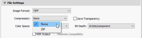

You set compression in the export dialog. For 16-bit tiffs, the options are None and ZIP.

"Do you always use the same compression setting when exporting?" I think so. Where can I check it?
