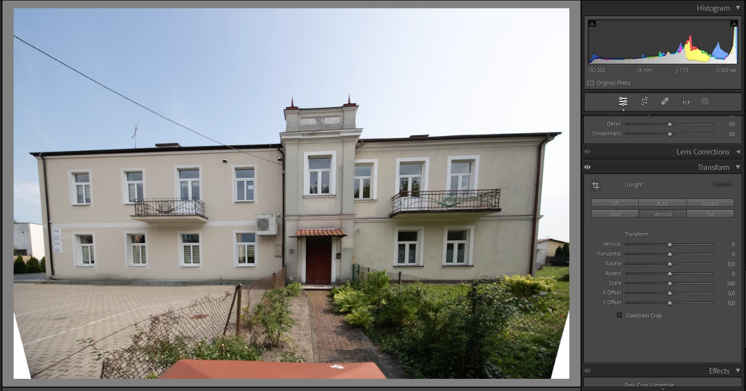

I used Transform -> Upright -> Vertical for for different individual photos of architecture. Simple thing. As a result, I very often get lines converging downwards instead of vertical lines (see attached picture). This makes the function useless.

From your screenshot I conclude that Upright has applied the strongest correction it is designed to, bur this has not quire removed the convergence altogether. I don't consider the function "useless" just because there's a sensible limit on how strong a correction it will apply.
As far as I can tell, the Upright tool is intended for quite moderate corrections that will not cause very severe distortions of proportion and of shape.

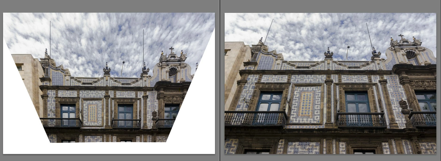

 LrC can achieve a stronger correction by combining with the Manual transform sliders (below the Upright options in the transform panel), also by using a Guided upright transform instead. The attached screenshot shows one of my own photos where I have forced a severe verticals correction, and illustrates I hope how aesthetically odd the results can be..
A different photo would have needed to be taken that did not require such extreme treatment, or else it should be accepted that in this case verticals are not sensibly going to show parallel.
Strong vertical convergence is part of the character and drama of some photos, and in any case consitutes their genuine perspective. This happens inherently when they were taken with the camera aimed significantly  upward or downward. The way to avoid it is to take the photo from a different vantage point or at least framed differently whihc may require a wider angle capture. The oddness doesn't go away when a physical shift-lens or pano stitching method is used, if the geometry of the representation is still unchanged.
Eliminating that verticals convergence artificially, IOW 'pretending' that the photo was taken from a different viewpoint than it really was,  is not guaranteed to be pictorially successful. At the least, cues within the photo such as subject proportions or even which parts of the scene are visible / not visible, will make this manipulation very apparent.

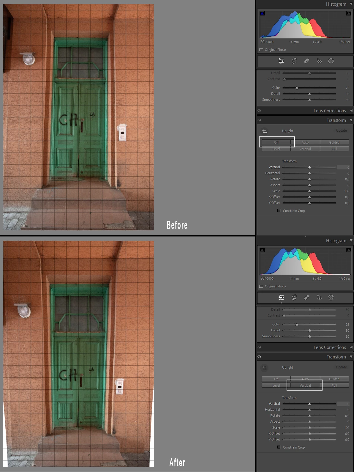

Thank you for your answer, Richard. I'm sure it's not about correcting strong convergence. For illustration, I left the edges of the photo after correction. It wasn't a strong perspective. Another example: door before and after correction of vertical lines. The perspective is weak, but the correction effect is wrong again. I showed the grid without any other correction, for better visibility of the line converging downwards.
August 10, 2023
One more observation: in the old versions of LrC the Upright correction worked very well.
