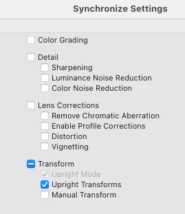

To work around this behavior, apply Vertical to the first photo. Then Sync with Transform > Upright Transforms selected:
This copies both the Upright Mode (Vertical) and the actual parameters of the transform computed for the first photo, ensuring all the target photos are transformed in exactly the same way.
