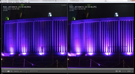

This is a known issue when using blue-purple lighting in the ultraviolet color spectrum.
https://feedback-readonly.photoshop.com/conversations/camera-raw-and-dng/lightroom-441-raw-develoment-versus-camera-raw/5f5f45464b561a3d4240a230
As @Jao vdL mentions try using the 'Camera' named profiles.
February 20, 2022
I knew this was an old issue but didn't rrealize it was that old! I've seen this before myself on blue/purple lighting such as neon or stage lighting. It is very profile specific indeed.

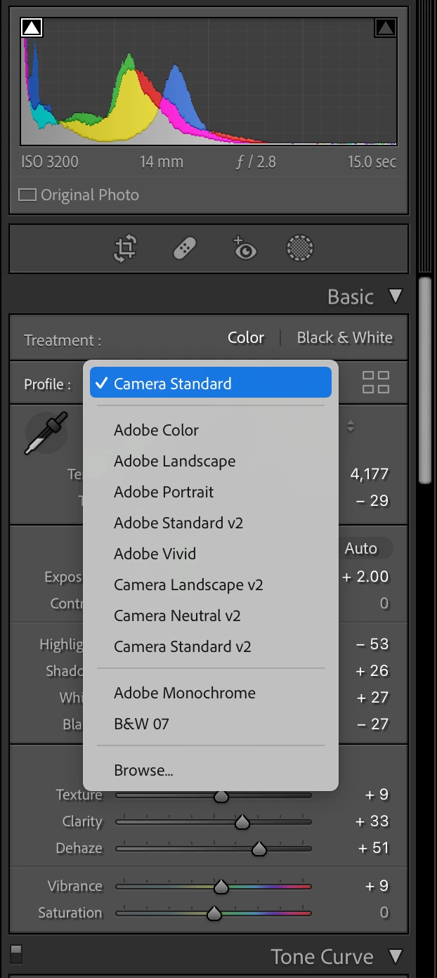

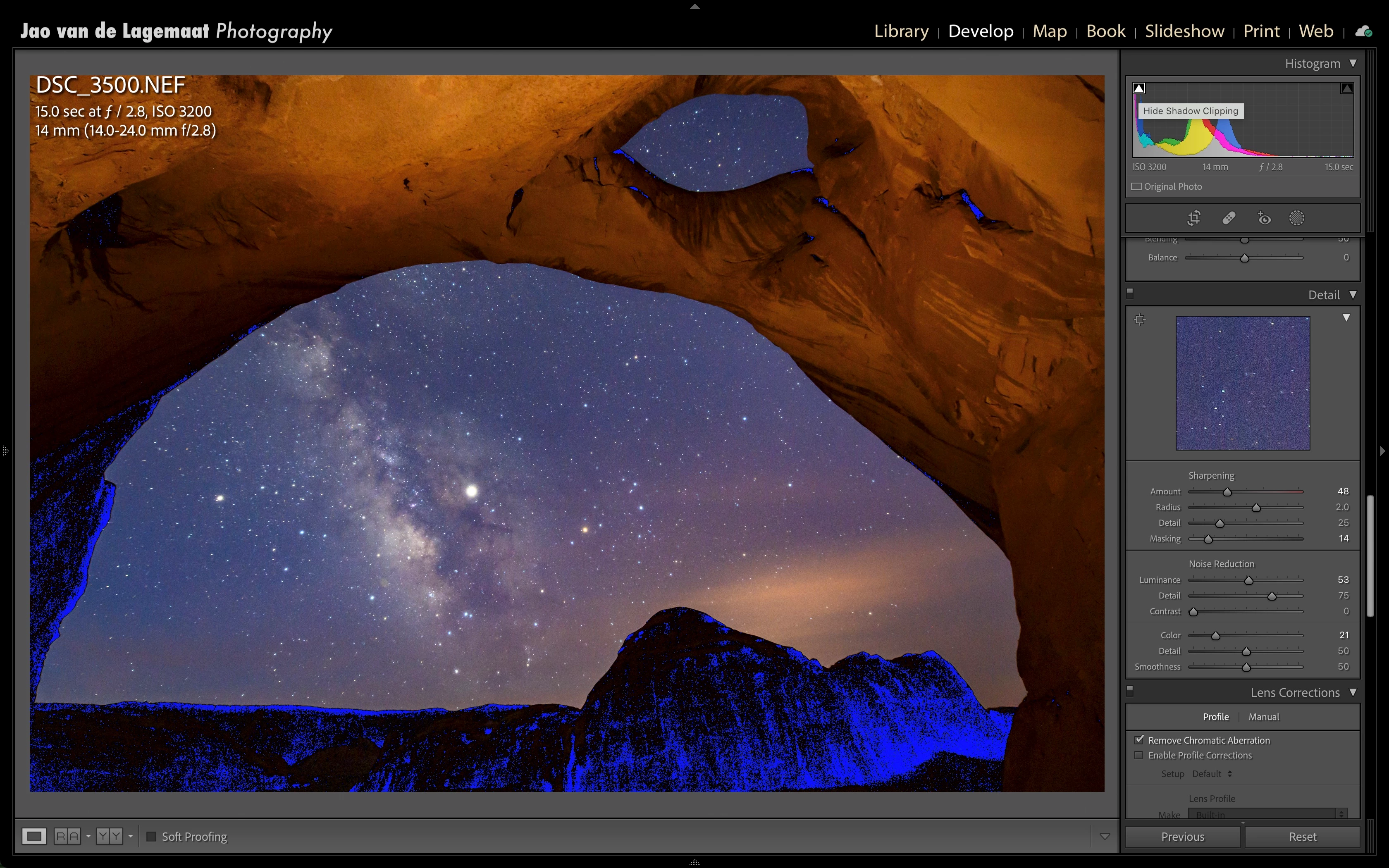

This might be the underexposure warning. It is by default a blue color. See here for the effect and where to turn it on/off (the little triangle top left of the histogram)
If this warning is not turned on, the problem is very likely the profile you selected. Try using camera standard or Adobe standard for example:

February 22, 2022
Adjusting the camera profile helped loads! Turns out this was a clipping issue due to the LED's
