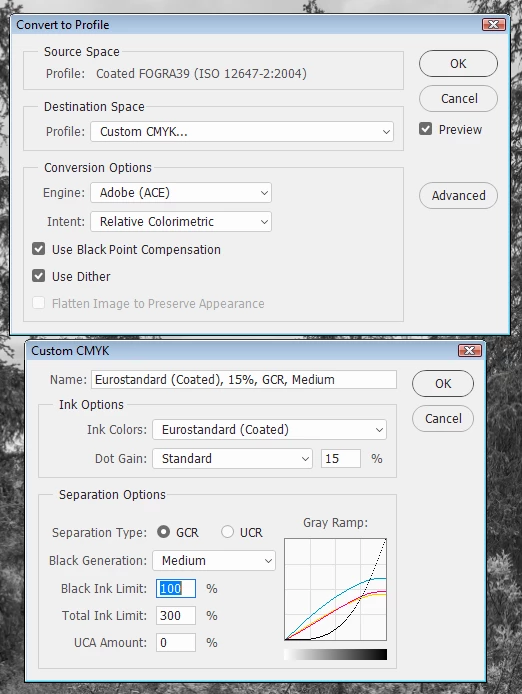

Open the CMYK file in Photoshop, then go to Edit > Convert to profile, and choose Custom CMYK, which will open this dialog.

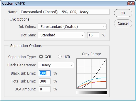

By default, the GCR (Gray component replacement)  is set to Medium.
Changing the GCR to Heavy, uses less CMY and more black ink, as you can see from the curves.
With less colored ink, the magenta cast will be reduced when viewing in artificial light.
Please note that the other settings in this dialog are just default settings. Using this workflow would require that you work closely with the printer, who should be able to tell you what settings to use. I guess not all printers would be willing to, or have the required knowledge to do this. And you should of course do a test run first, and also be present when the real job is done.
