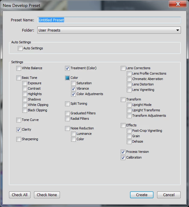

There's no simple way to "reverse-engineer" the Panasonic creative filters, but you an do that with any LR Develop preset. This will help you to determine what controls are used to produce different effects. From inside LR go to Edit> Preferences> Presets and click on 'Show Lightroom Presets Folder.' Open the 'Lightroom' folder and then the 'Develop Presets' folder. Open any of the preset folders such as 'Lightroom Presets' and then open the .lrtemplate using any text editor. This will show a list of the controls used and their settings. Some of the non-Adobe third-party LR creative plugins install both a custom Develop preset and a camera profile, which isn't as easy to reverse-engineer. What you can do is use one of the 'Camera' named profiles in the Develop module Camera Calibration panel's 'Profile' selector. Next use other Develop controls to obtain the desired rendering and then create a Develop preset that includes those controls. Make sure 'Process Version' and 'Calibration' is also checked. Here's an example for creating a Develop preset that uses the Clarity, Vibrance, Tone Curve and HSL controls along with a 'Camera' named profile
