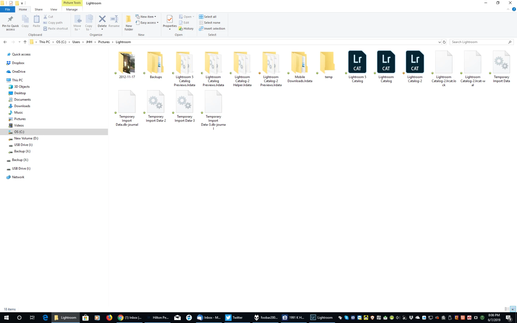

Thanks! I'd like to try that but I have no clue how to find the right .Ircrat file.
I'm seeing 3 LR Cat files with black SD card shaped icons: (LR 5 cat. (280mb, 7/19/2015), LR Cat. (1.5G, 6/7/2019), and LR Cat-2 (163mb, 6/7/2019), all three described (when hovering) as "Adobe Lightroom Classic CC."
Also 2 LR cat-2.lrcat files with translucent icons:  Cat-2 lrcat.lo ("ck" under that) and Cat-2 lrcat-w ("al" under that).
If I saw a LR cat.lrcat (not -2) I'd assume that is my target file, but I'm not seeing one.
All that is on the C drive. I keep my pics on the D drive and it has a LR 5 Cat (black icon, 148 kb, 11/13/2018, created 4 days earlier) and a LR cat previews.lrdata folder (normal folder icon, 1.23mb, 1/5/2014).
