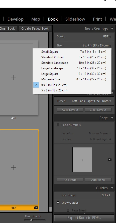

 Sadly I began my book in a "pdf version". In the pdf version i cannot change the paper type.
But to use the "blurb version" (with this version, i can change the paper type) i have to go back to 240 pages. So if i do this i have to delete 150 pages of my book...
How can i add pages in the "pdf version" of my book?
For the PDF version, you can add pages beyond 240 to the 6x9 in layout and to the 5x8 in layout but for other page sizes 240 is the page limit.
