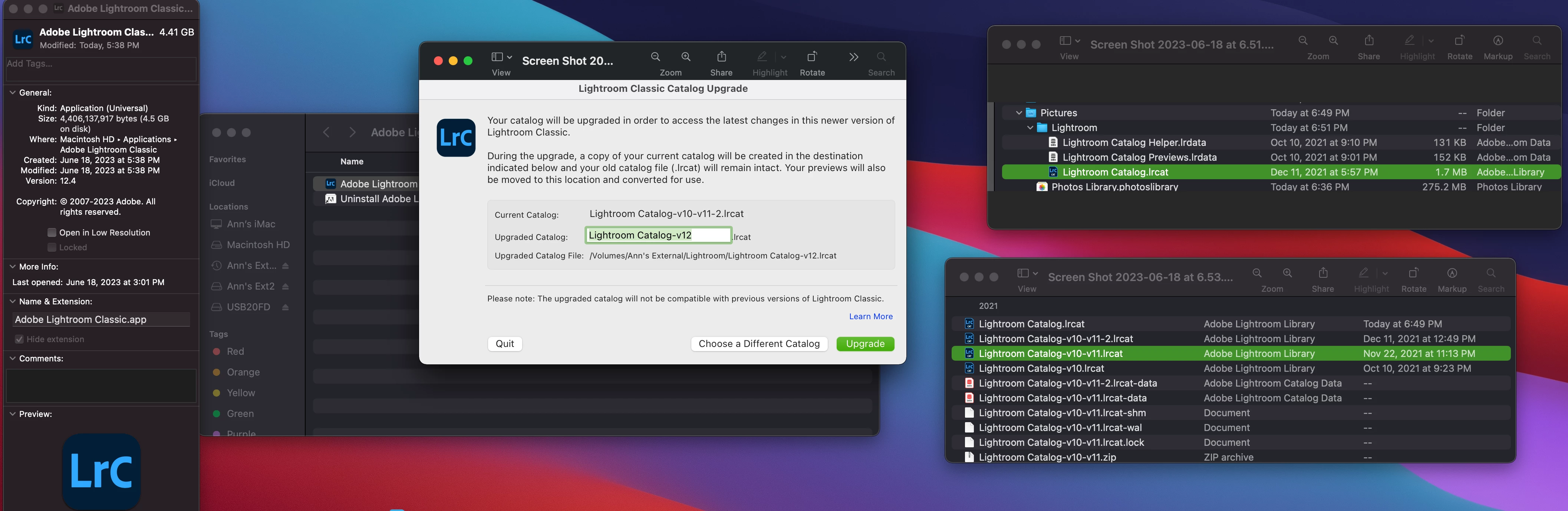

Hello All, Please I need some help....
Backstory:  There was a random power outage the other day, which has happened before and I figured out (I thought) how to manage...usually LR will say the catalog could not be found, so I quit the app, and restart.  Usually it will automatically load correctly but sometimes I have to point to the correct catalog and there have been no issues.  Until now.
When I re-started LR, I got a message that the catalog needed to be upgraded.  Fine, I've done that before, no big deal.  Picked the correct catalog and upgraded to V12.  When LR opened, I'd lost 2 years worth of photos... I don't know what catalog it updated but this obviously was a major 'uh-oh' moment and a problem. Tried several times to pick another catalog to load, but the only option I keep getting is to upgrade a catalog.   I don't want to do this, I want to cancel any catalog upgrade and load the correct catalog first, and then upgrade once I've seen all the photos are there.  There seems to be no way to cancel the upgrade other than a force-quit (I'm on a MAC).  I trashed all instances of V12 in hopes that LR would just work like it always has and find and load my last catalog with all of my photos.  But it still is requiring a catalog update to open and there is no option to cancel and just load the catalog and update later.  I can't figure out how to do this, can someone please help?  My version of LR is 12.3, which was updated April 29.  Oddly enough, I experienced a power outage of 4 days after I last updated LR due to storms and was able to restart with no problems afterwards.  This last outage had seemingly no reason and came back on within a few minutes but wow this situation is new.  Sorry for the mini-rant within the question, I'm hoping I'm stressing for no reason about not seeing 2 years of photos and there is a solution, also wondering why there is no option to cancel/delay a catalog upgrade when LR hasn't even loaded yet in order to check/backup first.  😞  Thank you so very much all in advance.

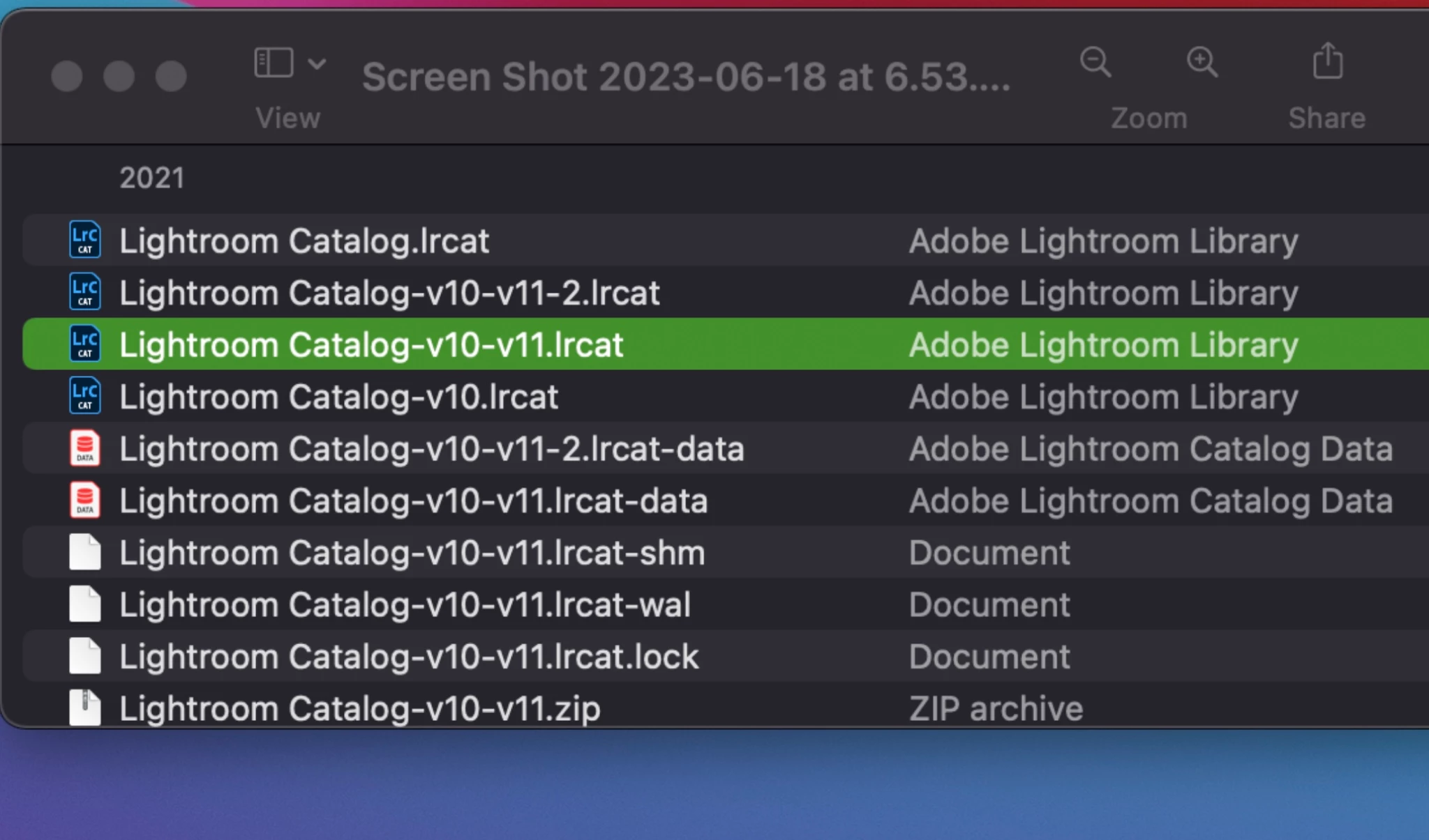

Hello All, wanted to update this thread.  I was finally able to open the correct older non-upgraded catalog by clicking it in Finder to open instead of opening LR first and choosing it within the program that way.  It did not ask me to upgrade the catalog, it just loaded it which was good but there were several months worth of missing photos.  Not an issue as LR had found them and I could see all the missing folders in the pane on the right and I had the option to import at the bottom of the pane.  I did that then created a backup which was a .zip file.   So I am back up and running now.  Lesson learned, I will make regular backups going forward!  Thank you.

Thank you Denis.  I've taken several different screenshots, the catalog you referenced doesn't show the different versions that have been upgraded.  What I want to load is the one showing v.10-v.11...not sure how it got labeled as both but it's the latest one.  It has a date of 2021?  But it includes all of 2022-23 so far.  And yes, I do not backup as regularly as I probably should but when I try to every time it hangs so I cancel.
DdeGannes
June 19, 2023
I have taken a clip from the screenshot you provided. My understanding is you wish to open the Catalog that is highlighted. If so then you are being prevented by the Lock file which has the same name as that Catalog with a .lock extention.
When Lightroom opens a Catalog it creates that file to prevent any access to the Catalog, the lock file will get removed when you quit Lightroom. However since Lightroom got shutdown due to the power loss the file has remained in place and is preventing use of the Catalog.
With Lightroom off, delete the .lock file and no other files in the folder then double click on the Catalog, the one you have highlighted, and that should boot Lightroom. You should get a prompt to upgrade it to Lightroom 12.
Let me know how that goes.
