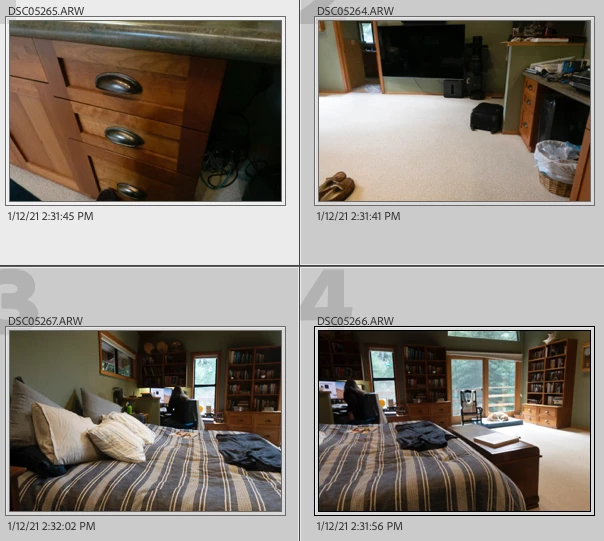

    As an example, I set my Sony RX100 V to "M" and Auto ISO and took four photos (ordered here by increasing exposure value):

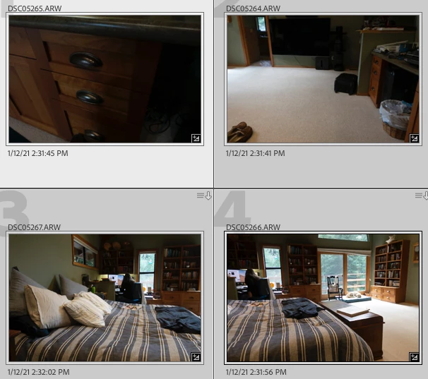

    Then I selected those photos, with the last (the one with the highest EV) as the most-selected, and did Match Total Exposures:
    The first three photos got darker, as expected.
    This table shows that LR adjusted the Exposure slider for each photo by - log2 (ISO / 2000):
