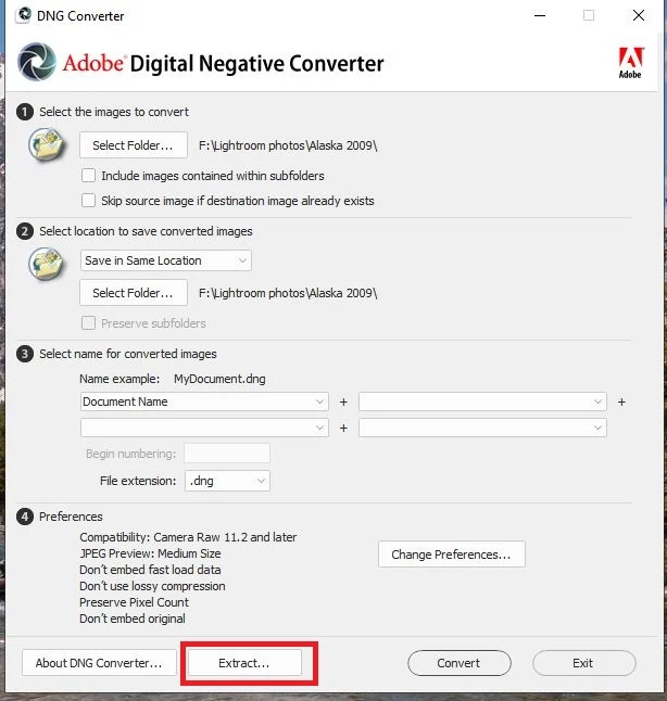

    "Does Extract tool work through Lightroom?"
    No.
    Run the Converter. Click on [Extract] button-
    Regards. My System: Windows-11, Lightroom-Classic 15.3, Photoshop 27.5, ACR 18.3, Lightroom 9.3, Lr-iOS 10.4.0, Bridge 16.0.3 .

    As Jim says- you Extract the CR2 data from within the DNG file using the (standalone software) Adobe DNG Converter.  And this presumes that you did in fact 'Embed' the CR2s within the DNG. And you did use that option (Embed) right? (and you doubled the file size?)
    Find the Download link for the Converter in this article- https://helpx.adobe.com/au/photoshop/digital-negative.html

    I only recently (July) began importing as DNG, so those files are only a DNG.  However,  I thought I could save storage by converting all of my previously imported CR2 files to DNG.  I unfortunately selected embed RAW file in DNG and the result was a CR2 and .xmp file plus the converted DNG for each image. I need to delete something, whether it's the DNG with embeded RAW file or the CR2 and .xmp file.  Where is EXTRACT and what will it do?  I'm running out of space in my 4-day old 8TB drive.

    The extract Option is a feature of the standalone DNG converter. It will enable you to select a folder on DNG files, and will extract the original raw file from each of the DNG files in that folder and place those raw files in a folder of your choosing.
