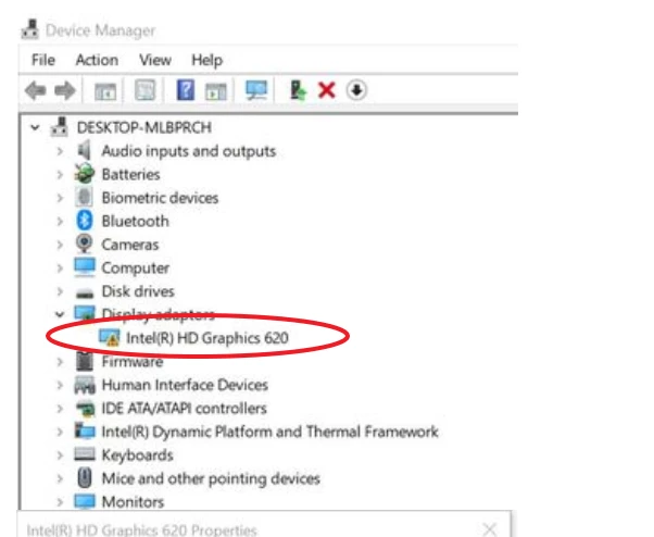

"processeur incompatible ... erreur 43 "
I wonder if that is an error message from your Windows OS triggered by Photoshop.
If in Windows, you bring up your Device Manager, do you see an error for the Video Card? Something like:
and see:
