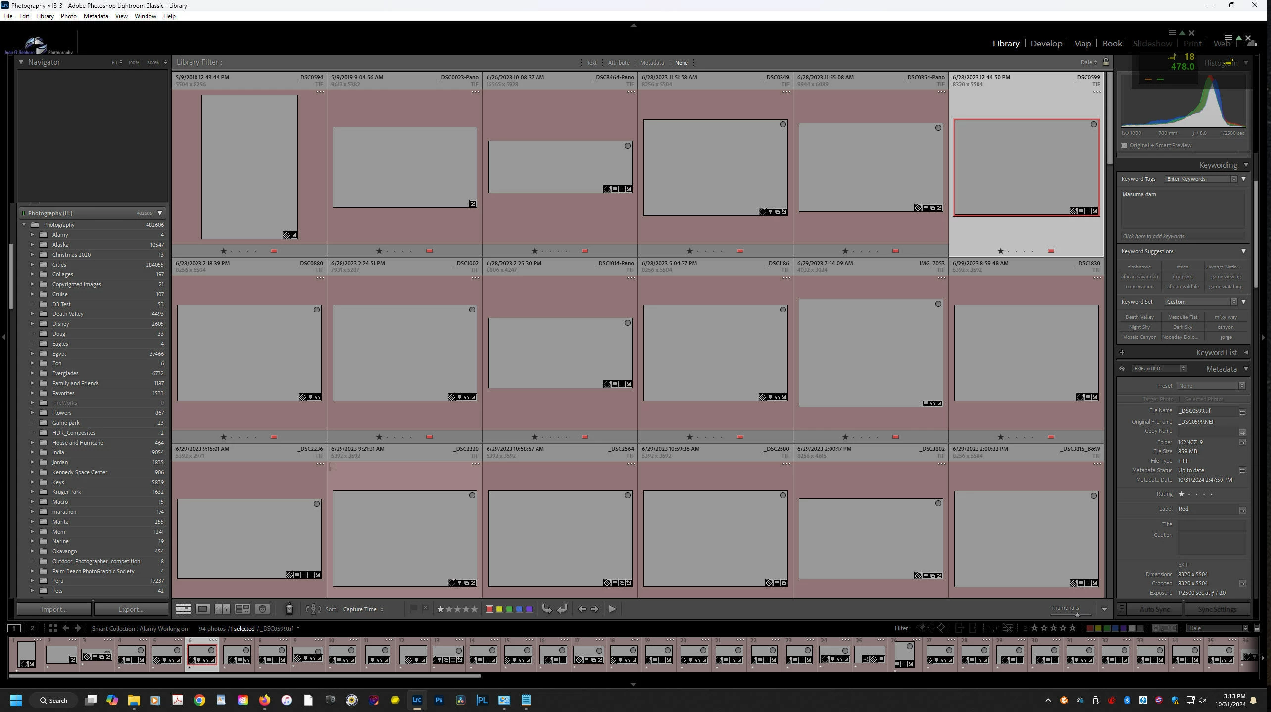

Once install was complete starting Lightroom 13.5.1 now resulted in no images being displayed – just gray boxes, or in the case where a color and star rating had been assigned, these were visible. As you can see the from screen grab below, Lightroom has access to the metadata associated with the images but it's as if the previews are somehow missing.

1. That screenshot of either Library or Develop module. It is too small to view, hard to tell what is what. It is like going to my Eye Dr, and trying to read that last line, fuzzy. Also, a more complete screenshot would help, the Histogram, the Navigation panel, and the Filmstrip can provide clues. Go for the full screen, and full size.

Attached you'll find the requested screen shot of the Library view and the configuration file as seen by Lightroom, As mentioned in my original post I believe somehow the Preview helper files are either locked or corrupt. Prior to this series of emails I had reverted to version 13 series of catalog files, which I had kept, and apart from the mismatch between disk and catalog the image previews were ok - you can refer to my response to CMass earlier. Of course I would prefer to use this catalog set of files rather than the version 13 set as it is a long wiinded and tedious process to get disk and catalog back in synch - again refer to the response to CMass

Your screen capture is so incredibly small that I am guessing you don't have missing photo indicators, but I can't be sure.
