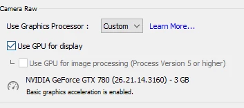

Hey Everyone,
I have just updated Lightroom Classic to the latest version and tried to Enable the new GPU image processing feature. When I go to the feature however the 'use GPU for image processing (Process version 5 or higher)' option is greyed out.
I have checked the suggested specs and can see that I meet them, I am currently on Windows 10 pro x64 running dual SLI Nvidia GTX 780's with the latest Nvidia driver as show below:
Video Card Details
Suggested Cards from GPU FAQ
I have read through the Adobe article (Adobe Lightroom GPU Troubleshooting and FAQ) and tried all mentioned workarounds/fixes, I have also turned off Dual SLI but the option is still greyed out as shown below.
Has anyone else experienced this issue and can provide some insight? any help would be greatly appreciated.
Thanks in Advance
Adriano

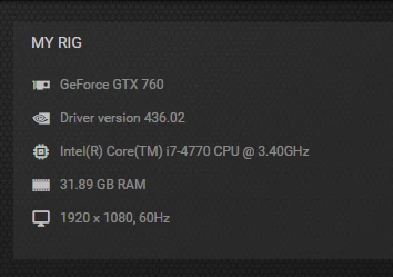

Aug 15, 2019 1:55 PM UTC
In MacOS 10.13 isn't available but when I install windows and all worked.... Lightroom is drastically improved when I retouching with my Wacom Pen tablet and Loupedeck+ controller... much more faster... but I want MacOS and will need to change video with Radeon VII to install new Catalina 10.15 and make it work like a charm...
Aug 15, 2019 1:51 PM UTC
I have the same issue, but with a single GTX760, same driver version (431.60) on latest Win10 Fast Ring.

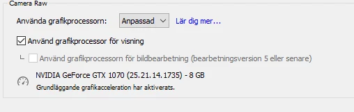

Bertilsson
Aug 15, 2019 11:27 AM UTC
I also beleve that my GPU should be supportedm but choise is greyed out:
Updated LRC today direktx12 according to win10

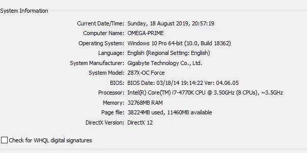

Aid81
Aid81Author
Aug 18, 2019 11:13 AM UTC

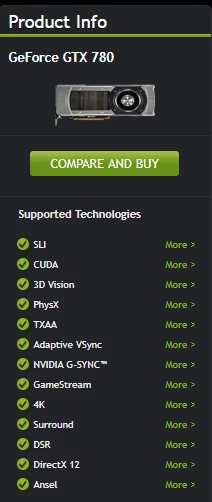

Hey Everyone,
Here is a little more information on my system, below is a screenshot and link to the product page from my Graphics cards, on the Nvidia website you can see that it states that it supports directx 12.
GeForce GTX 780 Graphics Card with Kepler Technology | GeForce | GeForce
Below is also the dxdiag information from my computer and you can see here that my system is running DirectX 12. So not entirely sure why this would not be working as everything I've read so far says that it should be and not entirely sure if the issue I mentioned above from that other forum relates to this.

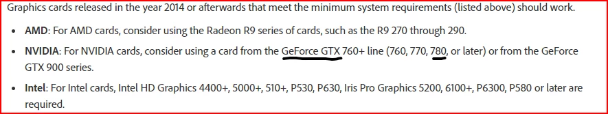

Todd Shaner
Aug 14, 2019 1:18 PM UTC
'Use GPU for image processing' requires DirectX 12, which Nvidia says is not supported on the GTX 780 GPU.
DirectX 12 | Supported GPUs | GeForce
Aid81
Aid81Author
Aug 14, 2019 1:56 PM UTC
Hi Tod,
Thanks for sending that link and assisting, the 780 doesn’t appear in the list in that link, but there is other literature from Nvidia (and the web) that states it does, also if I check dxdiag I can see that my system is currently running directx 12.
Also according to Adobe’s own system spec’s in their FAQ my card is supported.
