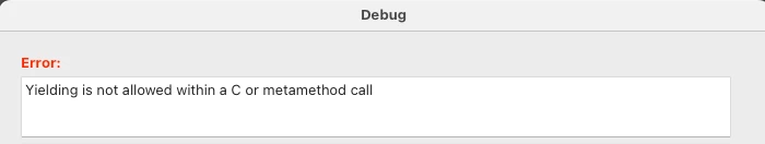

The callback functions passed to LrView methods are generally called from the main task, including the "action" function of an f:push_button().  But most of the methods of LrKeyword (and many other SDK objects) must be called from what the API documentation calls an "asynchronous" task"
An "asynchronous" task is simply one created by LrTask.
When one of these methods is executed on the main task, you'll get this mysterious runtime error:
You're not seeing that because LR silently stops execution of the task and doesn't display an error message.  If you want errors to be trapped and an error message to be display, you'll need to use this idiom to wrap the body of every tasks and callback function:
