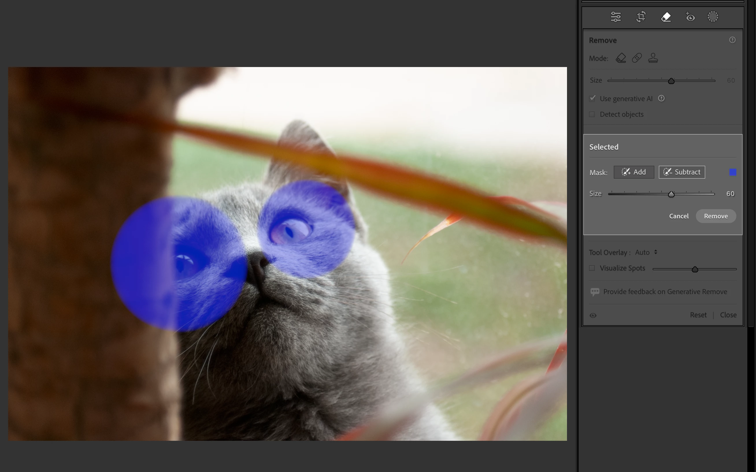

Steps to reproduce.
1. Paint a first "hole/stroke" (do not create the spot yet)
2. "Refine Add" another "hole/stroke" but not connected to the first one.
So the first set of dabs does not intersect with the second set and neither tis "close enough"
(Screenshot two hole/stroke")
3. Refine Subtract and "join/connect" the two holes.
Now all 3 sets are intersecting
4. Finally create the Remove.
Result: Two differet Spots were created and they both have a copy of same "subtract" masks.
So it is NOT sufficient to paint connected, intersected,  strokes because Subtractions do not count...probably because the function in place only considers "Add Masks" (i.e masks with MasKValue = 1)
