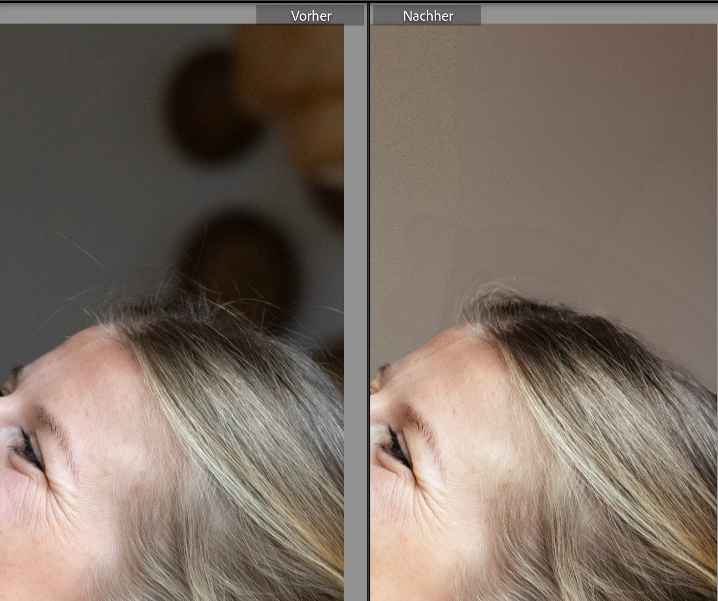

Visible transitions/borders through generative removal // How to avoid?
Hello everyone,
first of all, all the best for the new year!
I have a problem with removing disturbing elements in the background via generative removal. Normally this works quite well, but here the newly generated areas have a different grain (caused by ISO) and you can clearly see the transitions/borders to the original background.
Does anyone have any ideas on how I can improve this? Or do you know a good tutorial on how to do this?
Many thanks and best regards!

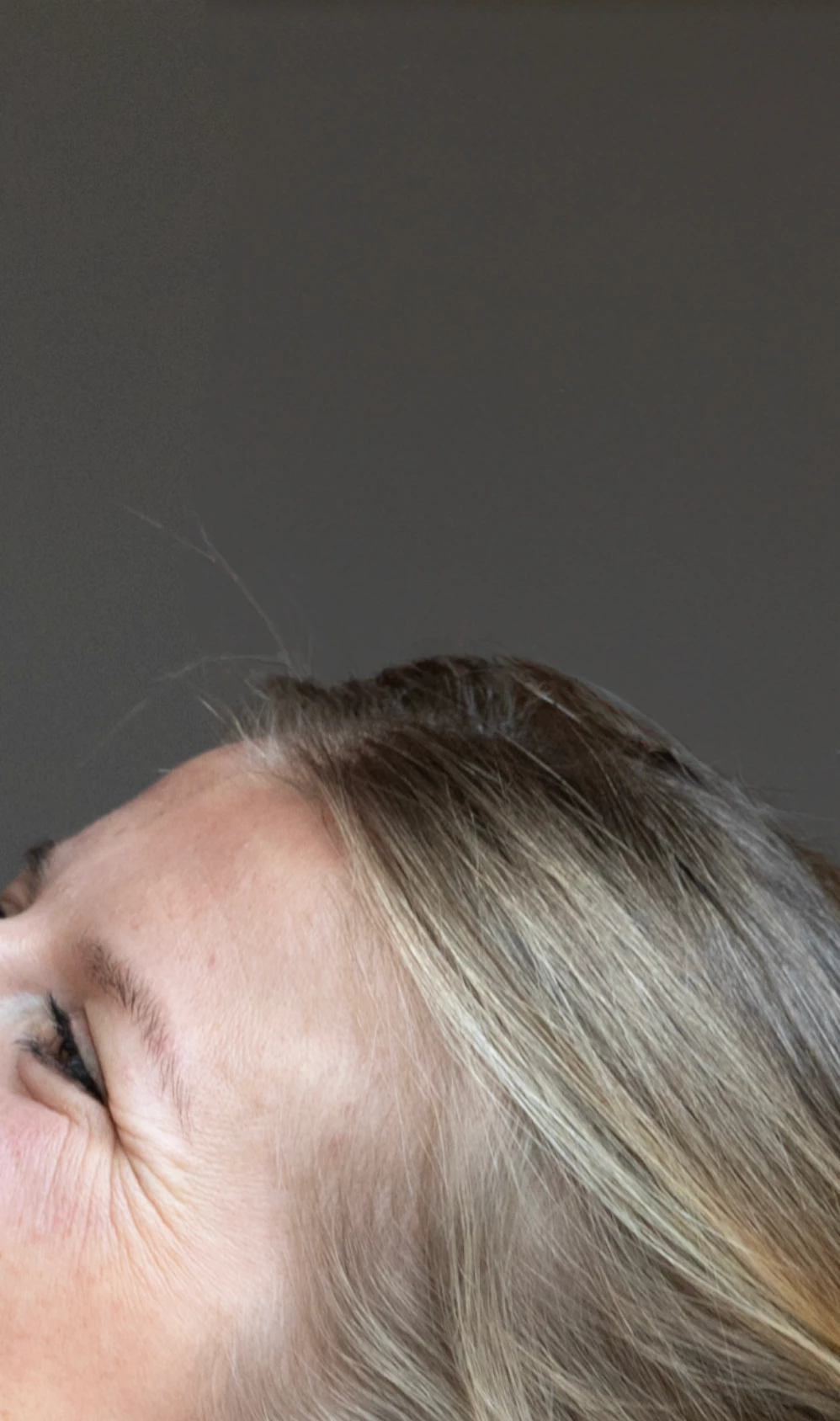

Here's an example using your screenshot. First I Removed one larger area rather than several smaller ones:

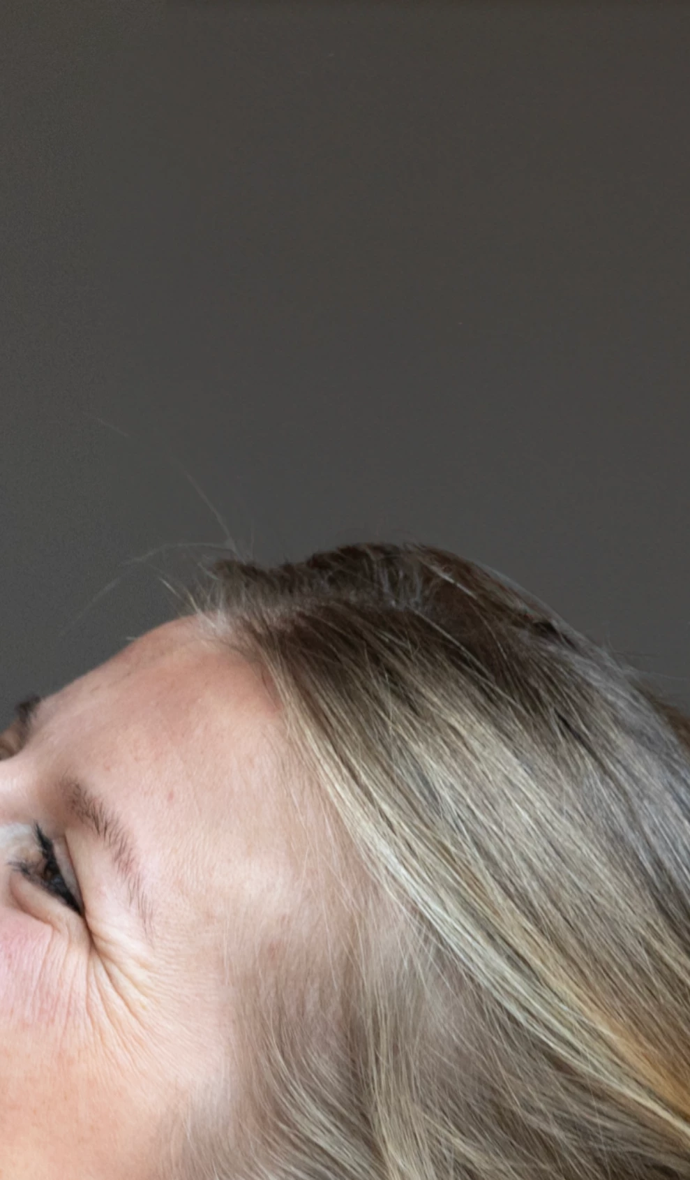

Then I applied the Healing tool along the hard left edge of the replacement, making it much less noticeable:
