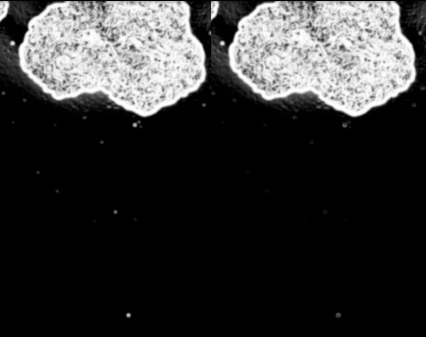

No, this is quite different. I've managed to capture a screenshot showing the difference:
On the left side is the regular view and on the right side is how it looks when you start to draw a selection using the "Remove" tool.
The spots get blurry and very dim and smaller spots are very, very hard to see, especially when working in a bright office environment. As I mentioned this only happens at a zoom level of 66.7%, at other zoom levels it does not happen.

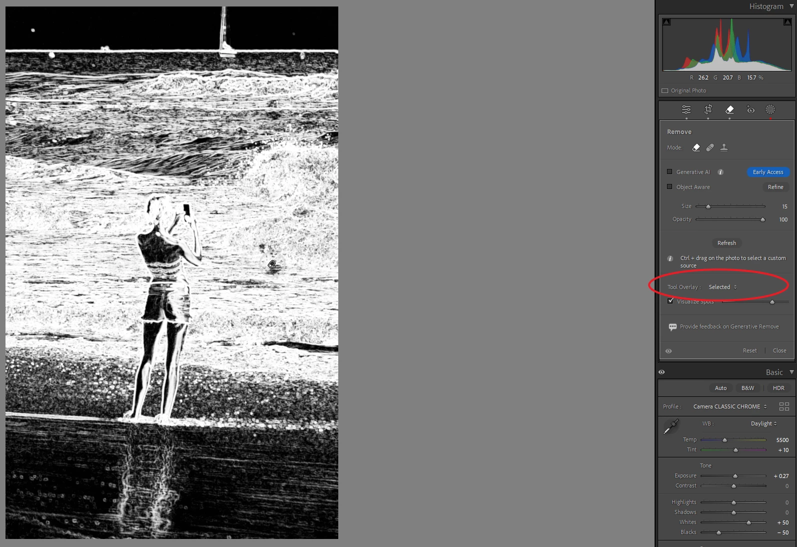

Tool Overlay???
August 2, 2024
Tool overlay only adjusts the visibility of the areas you aready worked on (meaning where the 'remove' tool has been used), not affect the visualisation of the spots.
But I just realised something: this behaviour only occurs when you have the current zoom level set to 66,7%!
It does not happen at 50%, 100%, 200%,... only at 66.7%
So this is definitely a bug.
