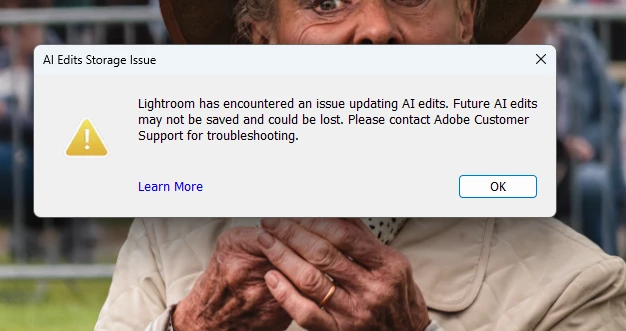

The original issue was that my weekly backups were failing and then I started to get AI edit errors (lots of them) - see attached. My issue is that Adobe will not learn if they do not accept feedback

Failing backups are usually cuased by catalog corruption. What you could try is this: Create a brand new catalog and choose 'File - Import from Another Catalog'. Select your old catalog to import. In the import dialog choose to import all photos, but do not move them. This will create an exact copy of your old catalog, but usually without the corruption. The only thing that won't come across is any publishing services you may have. You will have to recreate those. If you synced your catalog then you will have to enable sync for the new catalog. There are some reports that this could cause a problem. Here’s how to solve that: https://www.danhartfordphoto.com/blog/2025/1/lr026-fixing-sync-problems-caused-by-switching-the-sync-catalog
I can't view your screenshot. Attachments cannot be previewed because of a problem in this forum. Always embed them into your message, using this button:
Lightroom Classic stores AI masks and other AI data in 'Catalogname.lrcat-data'. Sometimes this file (Mac)/folder (Windows) gets corrupted, or the permissions are getting set wrongly, so Lightroom Classic cannot write to it. That leads to error messages about AI. If that is still your problem after done the above, then take the following steps:
1: Review this document: https://helpx.adobe.com/lightroom-classic/kb/ai-edits-storage-error.html to make sure you are not affected by the items listed there.
2: Contact Adobe Support as they have an lrcat-data recovery tool that can fix your corrupt file. Contact Adobe Customer Care at https://helpx.adobe.com/contact/what-contact-options.html. Scroll to the bottom and click on the “Start Now” live chat link in the lower right of this page. Typing “Agent” into the chat text field will bypass the initial chatbot.
