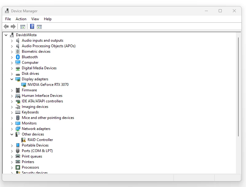

On your Windows PC, bring up the Device Manager, look at the Display Adapters. What does yours show? (please post a screenshot)
example (yours will not look like this):
and see:

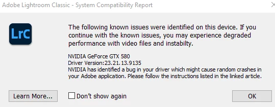

This error message. It sounds like a lightroom classic system compatibility report screen. Likely related to your integrated video controller on your motherboard. Perhaps related to that old GPU, perhaps to the OS (I think not, but..). Thing is, looking for an example I am finding none.
Can you post in a reply a screenshot of that error message?
