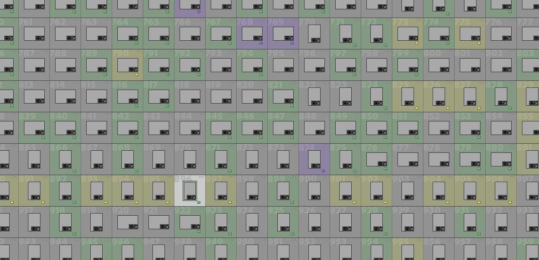

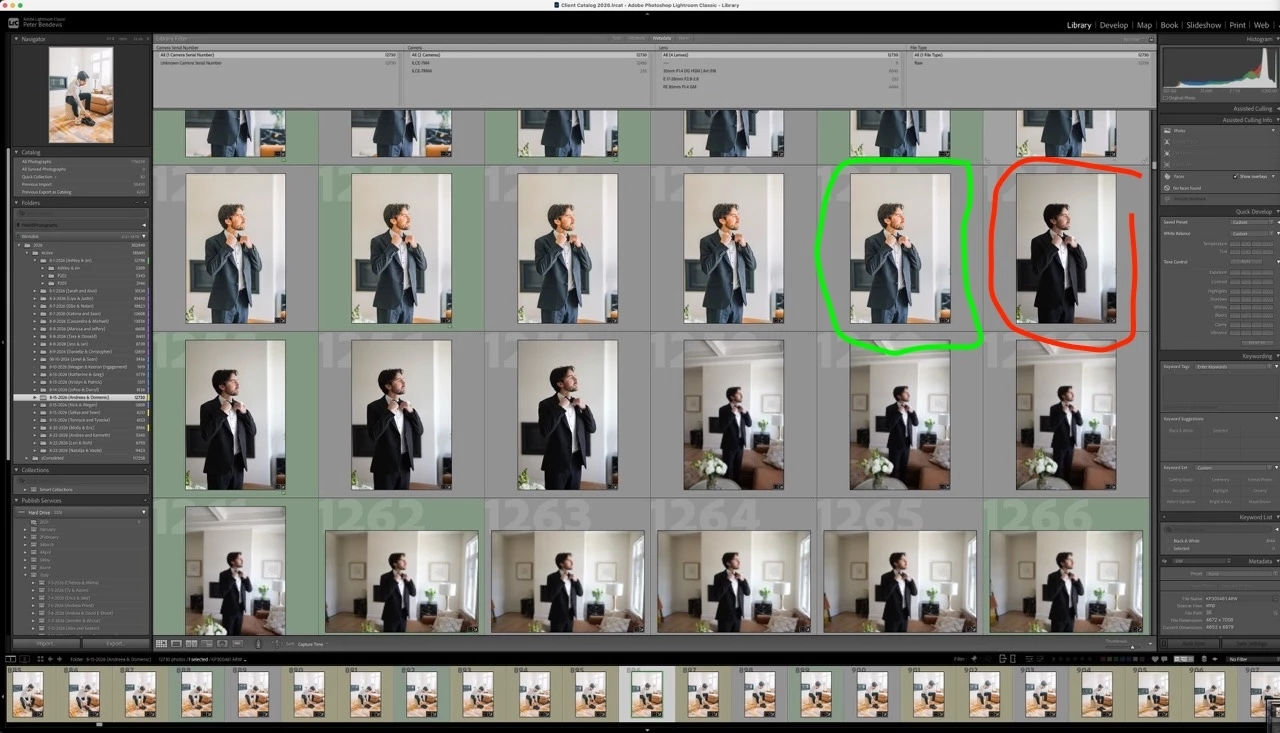

    I know the parent catalog loses all of its previews because when I browse the catalog in Library mode after the exporting bug, the photos all show up as empty grey boxes until I quit Lightroom. When I reopen Lightroom in Library mode all of the photos show up as unedited low res thumbnails and they are slowly regenerated into their edited versions as I browse or until I run “Generate Previews”.
    First Screenshot: What it looks like in the parent catalog immediately after exporting as catalog when the bug occurs. There is no way to see image thumbnails until LR is quit and reopened.
    Second Screenshot: Showing how the previews are not there and being regenerated on the fly. Green circle where the previews had regenerated to when the screenshot was taken. Red circle onwards has no previews.
