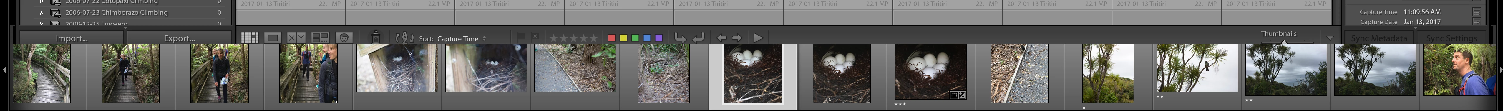

I may be missing something really obvious here, but since the latest update installed on LR, I can't seem to find the color label filter anymore? used to be beside 'rated' in the filmstrip, but it's not there now - anyone able to help this confused bloke before his head explodes?!

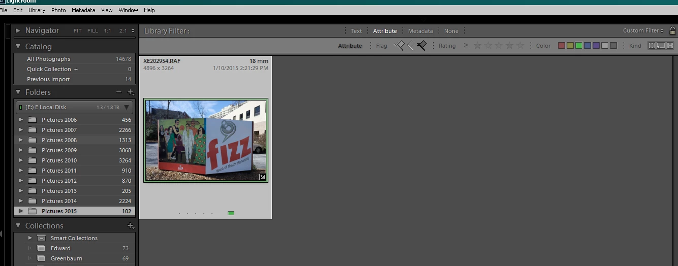

Can you see the Color Labels in the upper filter bar as Shooitstbond007 shows in the screen clip?  Not sure if the two are connected though

January 6, 2018
Click the word "Filter" and the labels will appear.

October 18, 2015
If it helps anyone, my problem was that color filters are no longer set as a "default filter". I clicked on the word "Filter:" on the far left of the screen and it expanded to show me more filter options (shown here), including colors. So weird.

There are two separate interface elements that basically do the same thing; even if you don't want to use the "Filter Bar", you still have make sure it's set correctly to affect the one on the bottom.
August 25, 2015
If you simply trigger filter by color from drop down menu at top, then it appears at bottom from now on. Or did on mine !

February 16, 2015
In the FilmStrip, as you move the cursor over the word "Filter" the cursor should change to a hand. This allows you to drag to the left, revealing the various filters, or to the right to hide them.
When the Library Filter is enabled, if you click "Filter" it contracts to whatever ratings/labels/flags you're filtering on. Click it again, and it will expand to include labels and flags. The behaviour is slightly different if the Library Filter is disabled.
From your screenshot, you probably need to click "Filter".

Bob Somrak
February 15, 2015
Not sure which color labels you are talking about so here are two clips.
Check if they are turned on with the filmstrip dropdown at the right end.
If thats not what you want than click the word "Filter" and the filter bar will expand and contract.

Davince.net
February 15, 2015
Hi Bob, the second one is the color labels I'm referring to - they aren't there?! clicking on 'Filter' expands it to show flags and stars, but no color label?
Just Shoot Me
February 15, 2015
In the Filter bar go to Attribute and you will see the Color labels.
