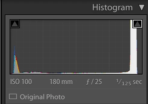

    Here is a histogram of a photo I took against a white background before I start processing it:
    Note that I have selected the triangle at the white end of histogram.
    Now I go to the Tone Curve and grab the curve until all the "near white" points are actually white. Because I selected the triangle above, Lightroom gives me feedback by showing the points that hit pure white by making them red in the image.
    Once you get the whites where you want them, then bend the tone curve back to linear for most of its range. This will put about 90% of the tones where you want them (depending on how many highlights you have in the image).
