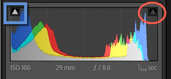

Hi Sockit,
I'll make it even easier for you: on your histogram you may or may not have noticed two little trangles in the upper corners.
The one on the right (red circle) will turn on or off any blown out over exposed regions and will show up red.
The one on the left (blue square) will turn on or off any underexposed regions in your image and will show up blue.
By using these, you can easily see regions in your images you need to be concerned about. IF you take raw imagse, you can probably recover and lost data by turning down the Highlight slider or sliding up the Shadow slider in addtion to changing the overall exposure. There are many other options for both controlling and enhancing the over or under saturated parts of your image but this will get you started.
But no, you do not have to "accept" seeing red or blue on your image while in the Develop mode.
sockitAuthor
March 3, 2021
Gary.   That is fascinating and very helpful. I have now started taking Raw images as they are so much better than JPEG's   I have been balancing the highlight and shadow sliders with the exposure to get the best balanced picture, and find that the high clipping signal is very useful. I have never seen the blue signal but will try to turn it on to try it out.
