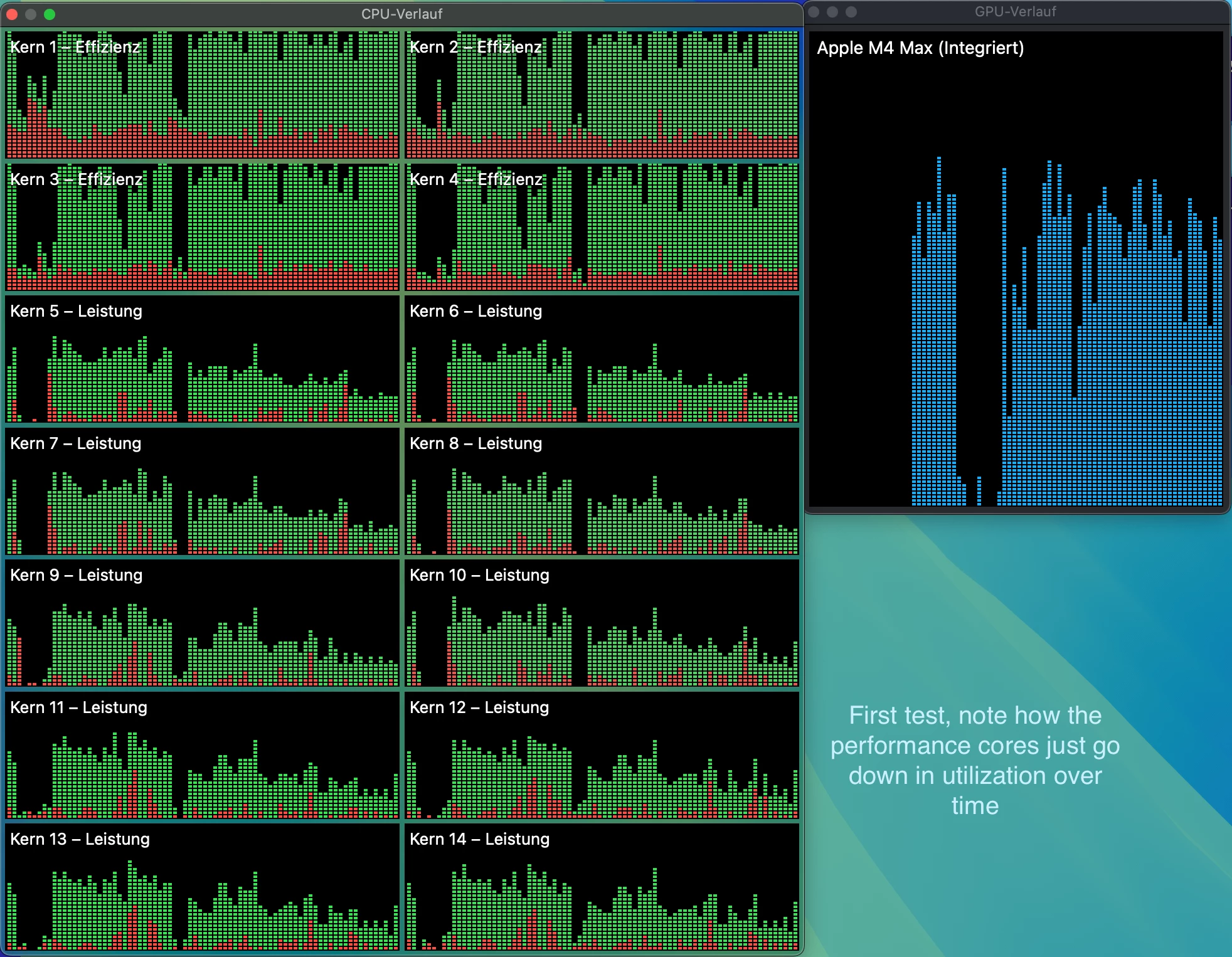

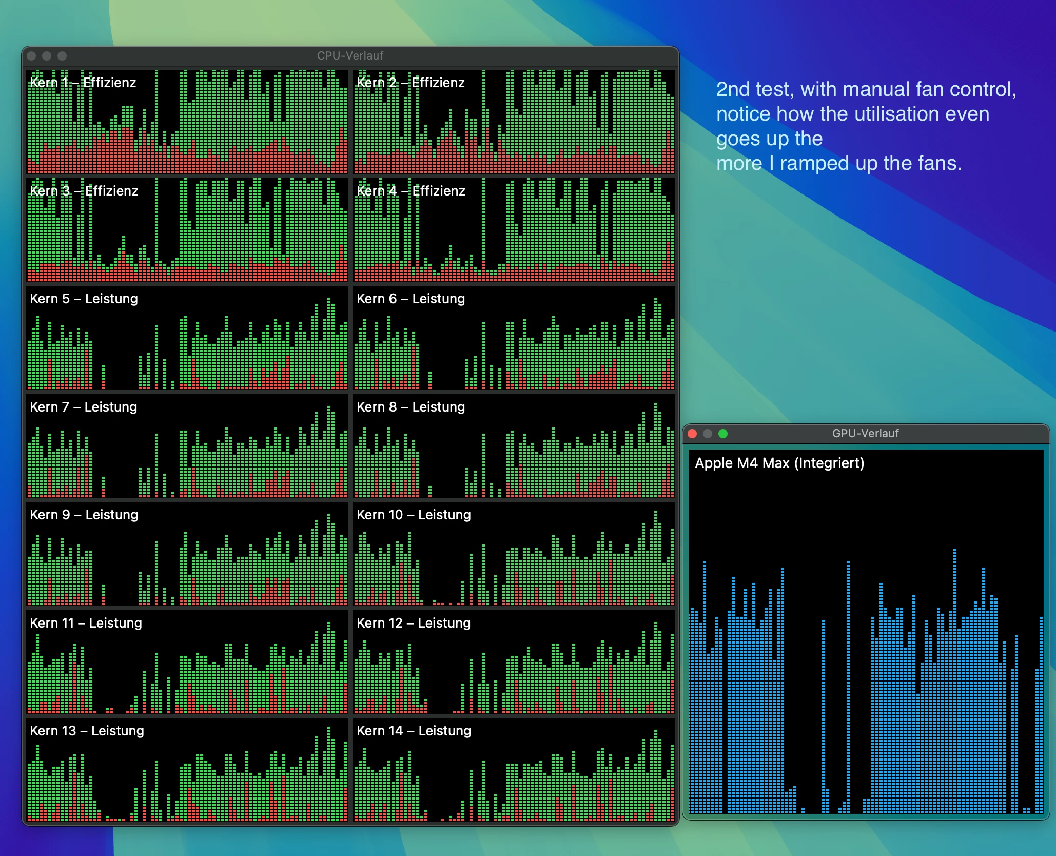

It's very interesting, I did some more testing..  and I found that it seems to be some sort of thermal throttling behavior that's going on.. The first 230 images or so get exported super fast, also using all cores pretty fully. But when I then went on to export another 600 images, I saw the same odd behavior again of only the efficiency cores being maxed out while the rest is at 30-40% utilization. Same for the GPU. I then manually ramped up the fans (which were almost unnoticable up to this point) and oh voila- suddenly, the cpus are working much harder again too!
What kind of brought me on this track was that I watched a review of the m4 macbook air, which doesnt have active cooling, and shows the exact same behavior after a short time of LR exporting. But I find it really super odd that my macbook doesnt ramp up the fans by itself to give the CPU more headroom to use its full potential. Especially since the fans ARE spinning super loudly by themselves when I do something like AI retouching with Arams that uses the GPU to it's maximum. The fans are at absolute full blast right now while the gpu is crunching...
Can that be something LR related or is that more like a problem with my specific machine or Mac OS even?
Please have a loot at the attached screenshots, and find below the log:

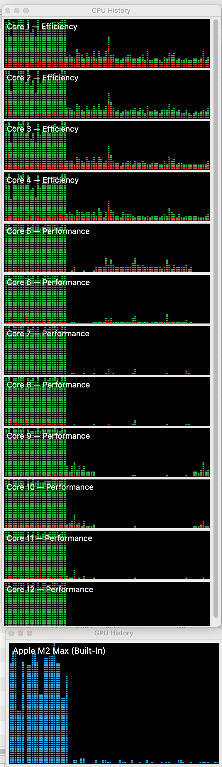

Very interesting. I observed the same behavior on my Macbook M2 Max exporting 1000 raws from and to the internal SSD:
(See the attached spreadsheet.)
After 364 files, the Mac throttled back on the GPU and performance cores. (Maybe the GPU was throttled and the performance cores were limited by that; or maybe the performance cores were throttled, and the GPU limited by that; or maybe both were throttled.)
Overall, keeping the fans on increased the rate of export by 23%.  But just comparing the time when the GPU and cores were throttled (after the first 364 files), the rate of export was 41% faster with the fans on.
I don't think this is under the direct control of LR (or any typical app). It's the operating system and firmware that decide when to throttle.
I didn't think there were thermal issues with the Apple Silicon Macbook Pros. The last years of the Intel Macbook Pros were notorious for their bad thermal engineering, with throttled CPUs due to overheating and fans that got easily  clogged.
It may be that the Apple designers have deliberately chosen to run the fans less aggressively in order to keep the Macbooks quieter. Many people really don't like to hear the fans running (like my wife).
