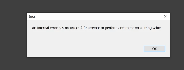

Thanks, and I downloaded the "DNG Recover Edges" and applied it but it didn't work.  I got an error:
January 5, 2022
That's quite an old utility now, and (I suppose) could not have been guaranteed to work on subsequent operating systems / with all Raw files. Whether it's EVEN in-camera aspect cropping you are experiencing, or something else, I was only speculating.
Have you tried fully Resetting the crop (rather than changing to Original aspect ratio)? Have you tried any other Raw converter software with the same photos?
