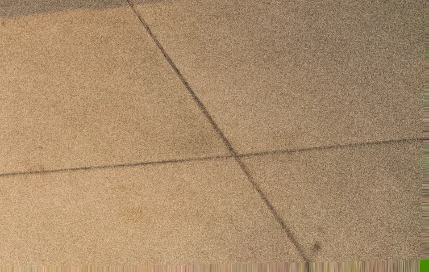

Why does this lines appear at the edge of the photo? only way to fix it is by cropping the photo.

I'm using a canon eos R3 with a Tamron 18-400. I also have that problem when I import into LR. I've discovered that by unchecking the remove chromatic aberration and enable lens correction boxes, no cropping is needed.  But those boxes being checked on import is a new problem.

I've had the same problem with my 24-240 lens on a Canon R6 Mk2. It only started a few months ago. I then noticed Lightroom had introduced a new Profile for this lens in their later updates,visible by clicking the right end of the Profile box. I selected v2 rather than the latest v3 and  the fault disappeared. I made v2 the default.

It's a known bug with the v3 profile. As you've discovered, using the v2 profile instead overcomes he issue. However, the v2 profile tends to have more corner vignetting than it should. Fortunately, this is easily corrected, should feel the need, by manually adjusting the Vignetting slider.

All of a sudden, I started having this same issue. Not on all images in the beginning and then later more and more. I thought it might be the card, but previewing the CR file in Preview was fine. The jpeg too. So it seemed to be only happening after import. First I was cropping that part out. But later found out that turning the Lens Correction off, removes these lines. I'm using the 24-240 lens.

I also just suddenly started having this issue with the same lens (Canon RF 24-240mm f/4-6.3). Seems to depend on what zoom setting the photo was taken on, but the exact connection isn't clear.

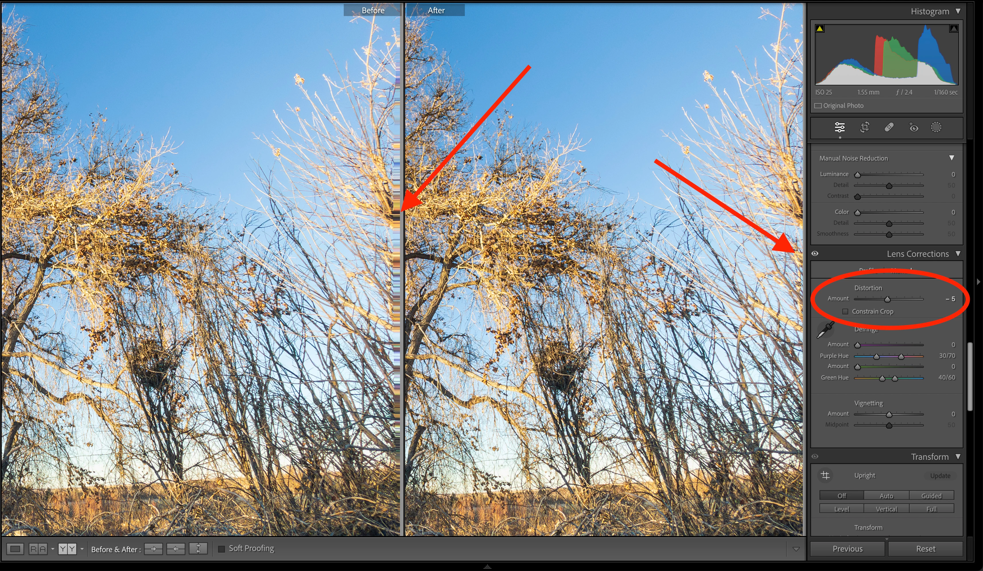

I recognize this. Adobe's lens correction profiles for several iPhone cameras (especially the ultrawide cameras) when shooting raw in the Lightroom app are not well tuned and this causes this smearing at the edges. Indeed only fix is cropping.
Edit: just remembered that an easier fix is to counteract the overcorrection of lens distortion in these files is to dial in manual lens distortion correction of -5:
Unfortunately Adobe does not allow one to turn off the built-in lens correction which would also fix this problem.

Had this same problem with Lightroom and my Canon RF 24-105 f2.8. I turned off the lens correction and the problem went away. I'm guessing LR needs an update for this relatively new lens.
