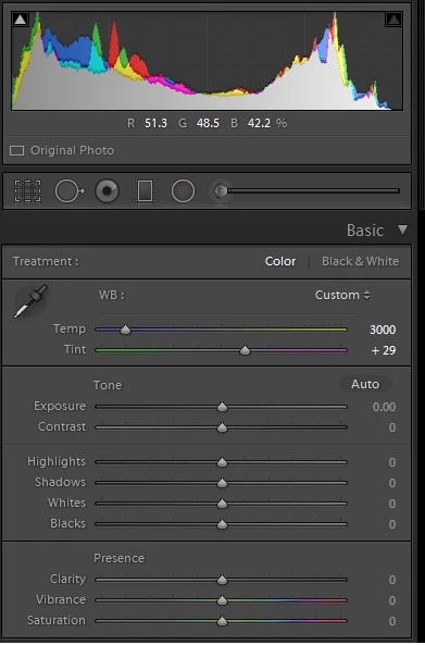

Please find histogram below.
dj_paige
January 23, 2017
The histogram looks fine, but you have certainly pushed the tint towards the magenta, perhaps that is the problem?
