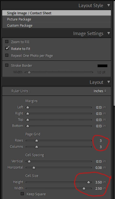

DS256Author
February 24, 2022
Rob, thank you so much. You caused me to go back and look at the Page Grid and Cell Size and I was able to make it work. I'd come up with a convoluted process involving exporting from LrC, into Bridge, Output to PDF then print the PDF.
Here are my settings
