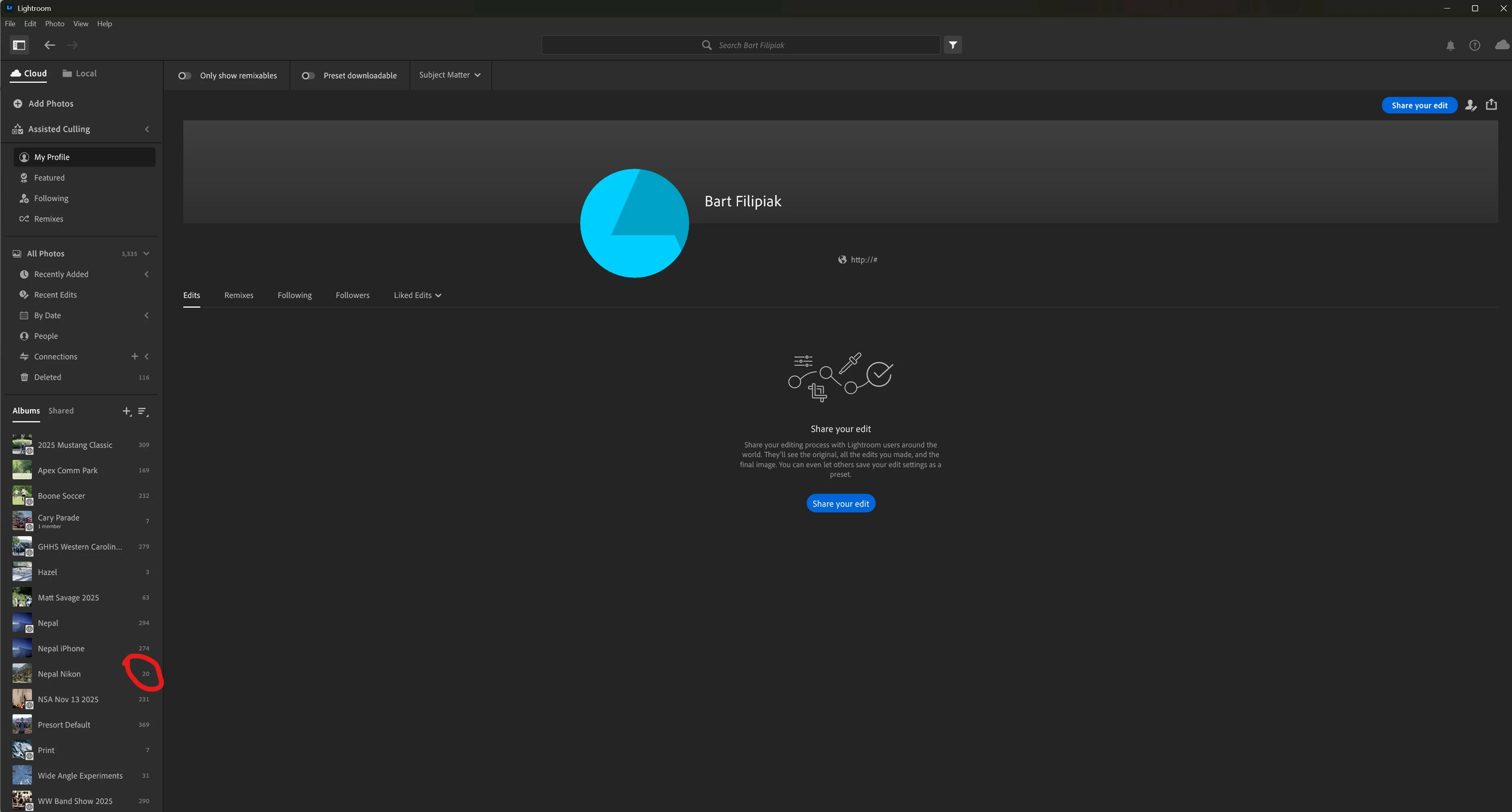

Apologies for the delayed response. If the photos are missing from the web version as well, it can be difficult to recover them. If the issue is still not resolved, please try updating to version 9.1. If the problem persists after the update, please share a screenshot showing all photos like this from your Lightroom desktop app.

bfilipiakAuthor
Dec 20, 2025 12:19 AM UTC
Thile album circled should have about 450 files in it instead of 20.  I have the RAW files backup so it's not a total loss.

Yes, I understand that the Album has a lot less photos than it should have, but you haven't addressed the questions that I raised in my first post. Specifically: is there a total mismatch between the Lightroom Desktop All Photos total and LrWeb's All Photos total, and have you checked to see if any of the 1100 images that are not in any album include some or all of the images that are missing from the albums?
Another way to view those 1100 images: click on All Photos, then click in the Search Bar (make sure the Filter icon is not highlighted) and select Album from the list of facets that are shown. In the list of albums that is then produced, scroll to the bottom of the list and click on the entry for "Not in Any Album".....that will populate the grid with all the images that are in the cloud but not assigned to any album. Does that list contain any of the images that you expected to see in one of the existing albums?
