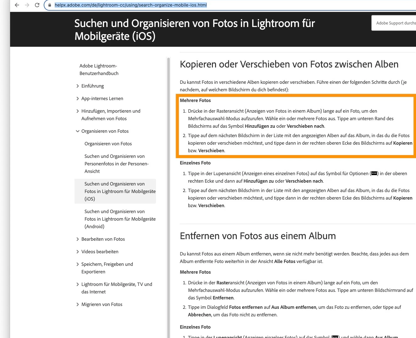

Adobe Employee
Nov 1, 2023 10:31 PM UTC
Hello @Heike33065578anyp
Do not use the Copy command, but please instead use Add To... Album (choosing the shared album belonging to the newer account).
1. Sign into your original account go to All Photos, select all the items.
2. Then tap Add To > Shared With Me, and select the shared album belonging to the new account.
3. Tap the Cloud icon to check if Lightroom is uploading/syncing to the cloud.  It may take a while to upload files, so please plug you device into power and keep the app open until syncing is complete
This page has some infos about Add to.. (Album) to help you: https://helpx.adobe.com/de/lightroom-cc/using/search-organize-mobile-ios.html
