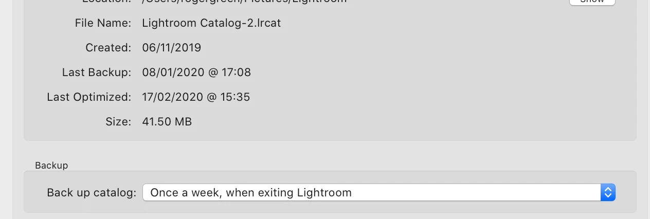

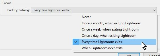

Thanks for screen-clips.
 it is set up for a weekly backup.
Change it! The drop-down menu will give you the options. I personally prefer the "every time Lr exits" as you do get a choice to "Skip the backup" if little work has been done.

Thanks.  I changed the backup frequency to "every time Lr exits" as you suggested and it then showed the prompt.  I shall now keep it as that as you say.

From the Main Menu- check your catalog Settings.  (is that [Cmd+Alt+,] on a Mac? )
Change the option for Backup frequency there.

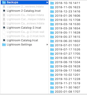

RogerG40767081
February 18, 2020
Thank you.
Catalogue settings below.  As you see it is set up for a weekly backup. But as you can also see in the second screen grab that the latest backup is 8th Jan although I have exited LR today so should be todays backup, yes?  I did optimize yesterday - whatever that does! Is there any way you can physically do a LR backup to get around all this?  I always used to get a prompt when exiting asking if I wanted to backup or not, but don't get this anymore.  Totally confused!  Appreciate any help.
