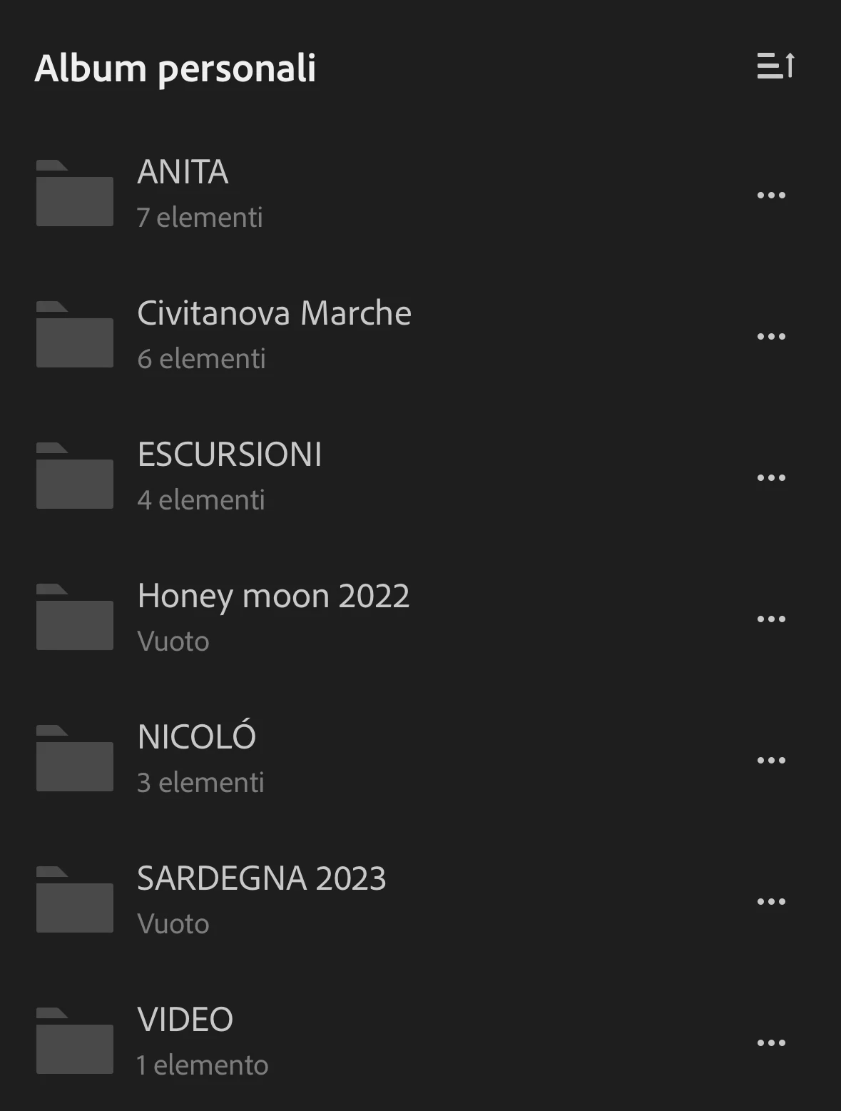

LuxRipAuthor
Sep 4, 2025 8:56 AM UTC
Hi Sameer, Thanks for your help, maybe I explained myself wrong.
For example in Lightroom from my iPhone/iPad I have this storage (see attached photo), divided by folders and within the folders many albums.
When I synchronise on Lightroom Classic I lose the folders and only see the separate albums.
My question is, is there a way to see the same type of storage in folders even in Lightroom Classic with synchronisation?

Sameer KCommunity ManagerCorrect answer
Sep 4, 2025 11:31 AM UTC
Thanks for the update. The description and the screenshot help. Currently, the Album folder structure from the Lightroom Ecosystem is not synced to Lightroom Classic and will only appear in a list form under the collections panel.
