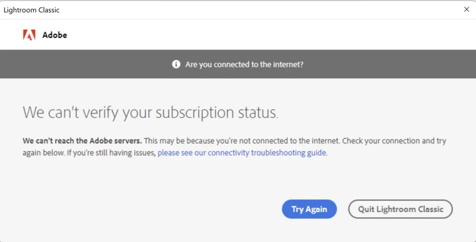

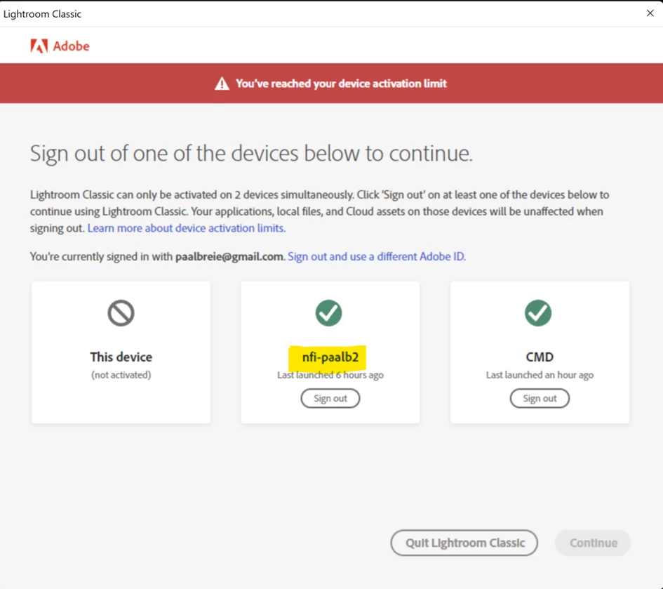

Sep 26, 2022 9:52 PM UTC
I start LR, first get a login prompt, and successfully log in with email + password.
Next I get this. While trying to start Lightroom on the highlighted computer, which now says "last launched 6 hours ago" ?
I sign out highlighted computer
…then I get this error:
I quit Lightroom Classic, starts up again, same sh*t happens again and I keep ending up on “can’t verify your subscription status”.
Need to reboot my laptop, go through another sign-in with email/pw, do another sign-out of highlighted computer, then finally Lightroom starts.
Its....a.....really....annoying....hassle 😊
