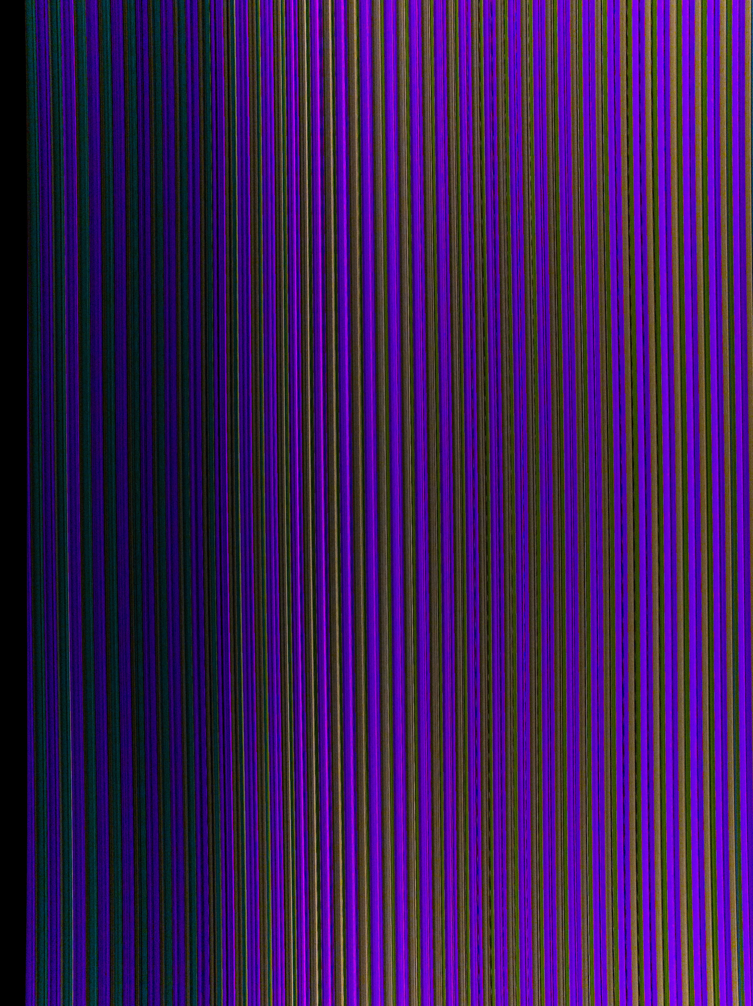

Corrupted DNG files on Samsung Galaxy S24 Ultra
When capturing photos directly from Lightroom in DNG format, on Samsung Galaxy S24 Ultra, they get corrupted. From within camera they look OK just after capture, but when trying to access them from library, I am getring only purple and violet vertical stripes.

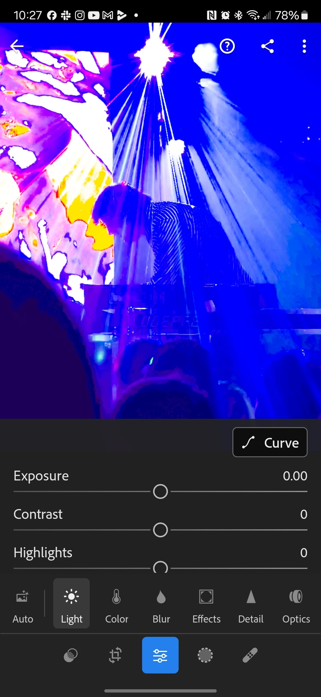

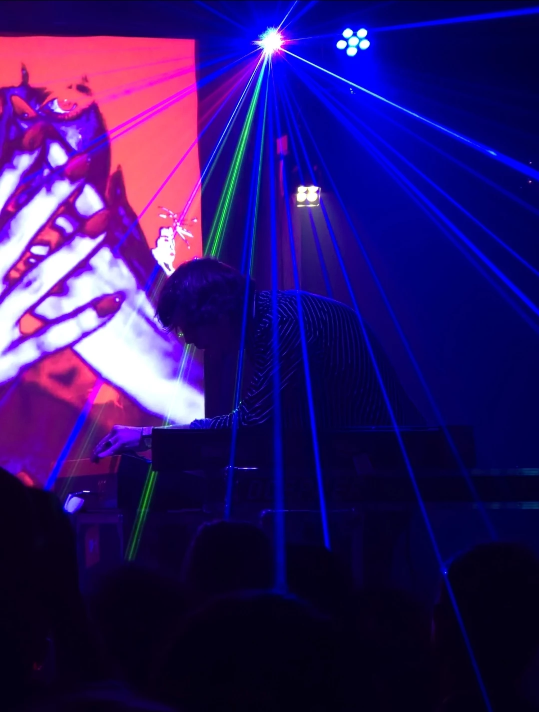

I've seen the same issue when using their expert raw camera app. I can fix most of the issues by doing lots of extra editing in the color mix section, so I believe this is something that Adobe could look into and offer better support for. Please consider!
Here's an example
How the raw photo looks in the gallery app.
 Here is how it is rendered in Lightroom

Samsung fixed the issue with an update to the Expert RAW camera app. Once you install the update, going to settings and disable the lossless raw option.
