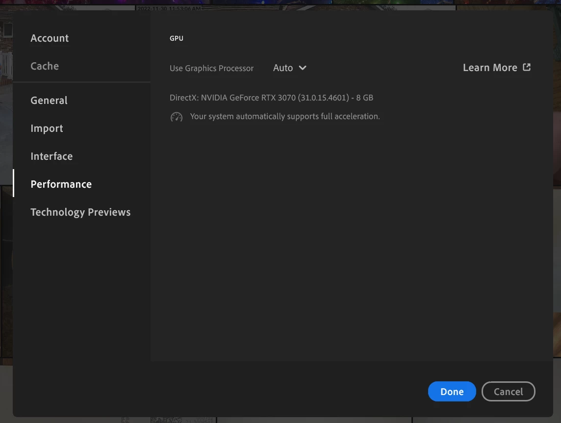

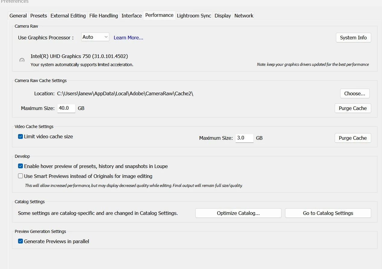

Can you in Lr, bring up your preferences, and look at the performance tab, and post a screenshot of that? Should look something like:

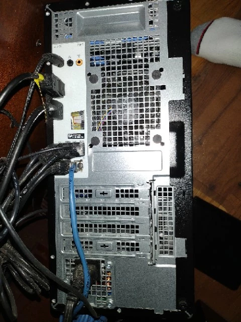

OK. This is intersting.....First:  This is a desktop, not laptop.  Dell tells me that the existing GPU board is descrete - but I am questioning that.  Looking at the computer back, the only monitor connections (I have two) are on the motherboard, based on your picture and mark ups. I do not see any connections on a GPU board, or any pci boards at all.  This has got to be an issue, I am thinking....See picture:
Screenshot as you requested (If I got the right one):

Where did you get that computer from?
When?
Did it include a manual?
Because the GPU is clearly not installed. (if it came with one)
I think that at Dell, you can lookup your specific computer based on serial number (ahh, a service tag, should be on a printed label) and see exactly what you got, at links to manuals, drivers, etc.
