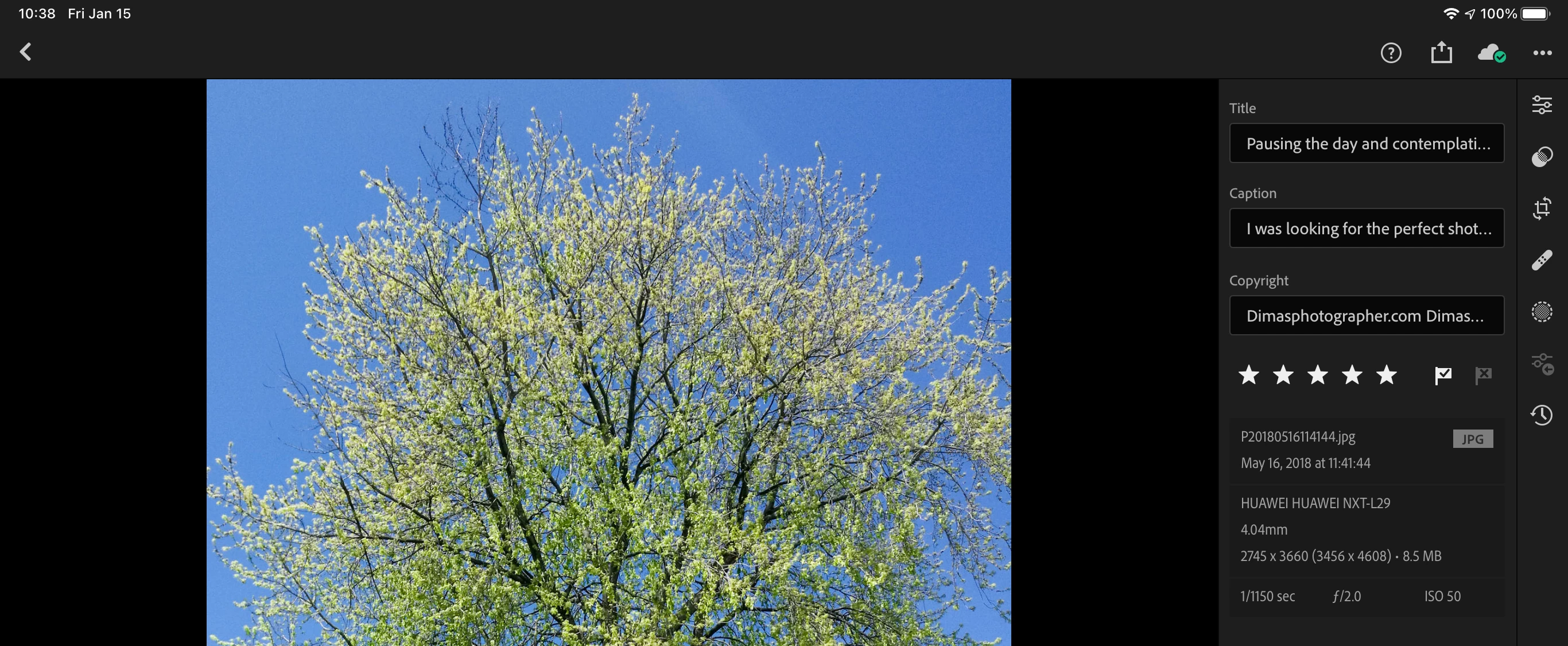

EXIF is not been exported on LR for iPad
Hi Folks, my first post here...

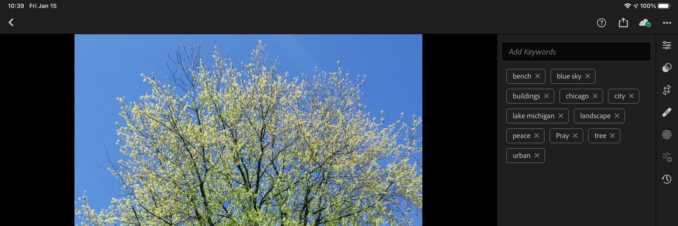

I am editing my pictures on iPad 2020 12.9 with Lightroom 6.1.0 and after I've added manually tags and change photo fields. When I export... there is nothing there...
Help? Please see attachments,
I checked with every app that I have, normally I do heavy editing on Affinty photo and there is nothing there too...
Please help!

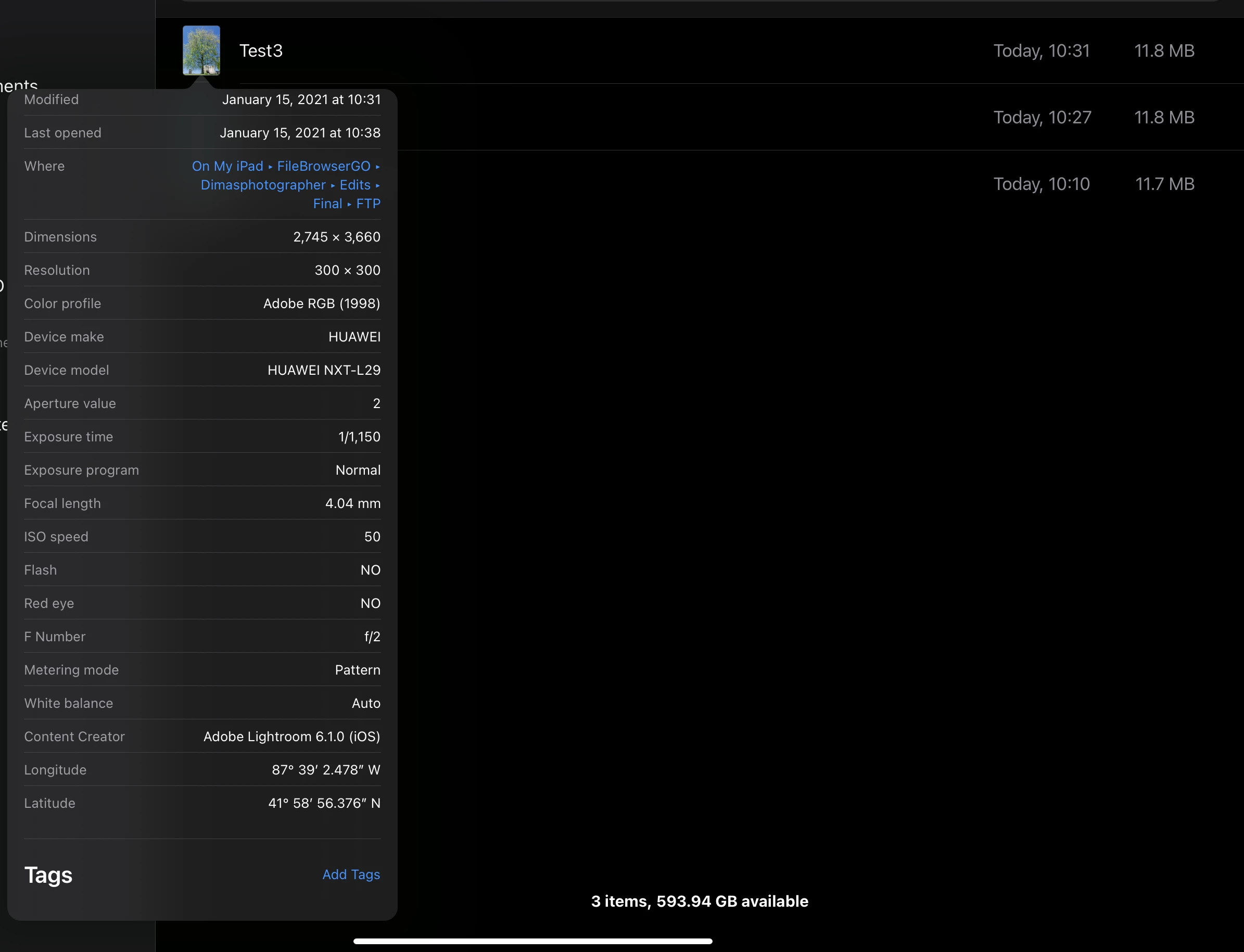

When I tried it using Export to Files, the caption and keyword metadata is present, and:
  • Not shown in iOS Files > Info
  • Shown in the EXIF Metadata app for iOS (very useful app by the way)
  • Shown in Affinity Photo for iOS in its Metadata Studio > File panel
  • Shown if transferred to a computer and viewed in Properties or Adobe Bridge
So one of the things you may be seeing is a limitation of metadata display in the Info panel in the iOS Files app.

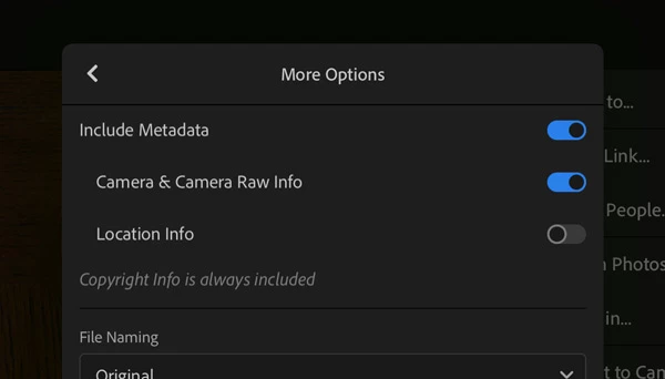

Also, just to make sure: When I exported from Lightroom on iPad, the Export to Files settings had Include Metadata enabled as shown below. If Include Metadata is disabled, the metadata will not be in the exported file.
Does any of this help narrow down the problem? Because it looks like it should be working if set up properly and viewed properly.
