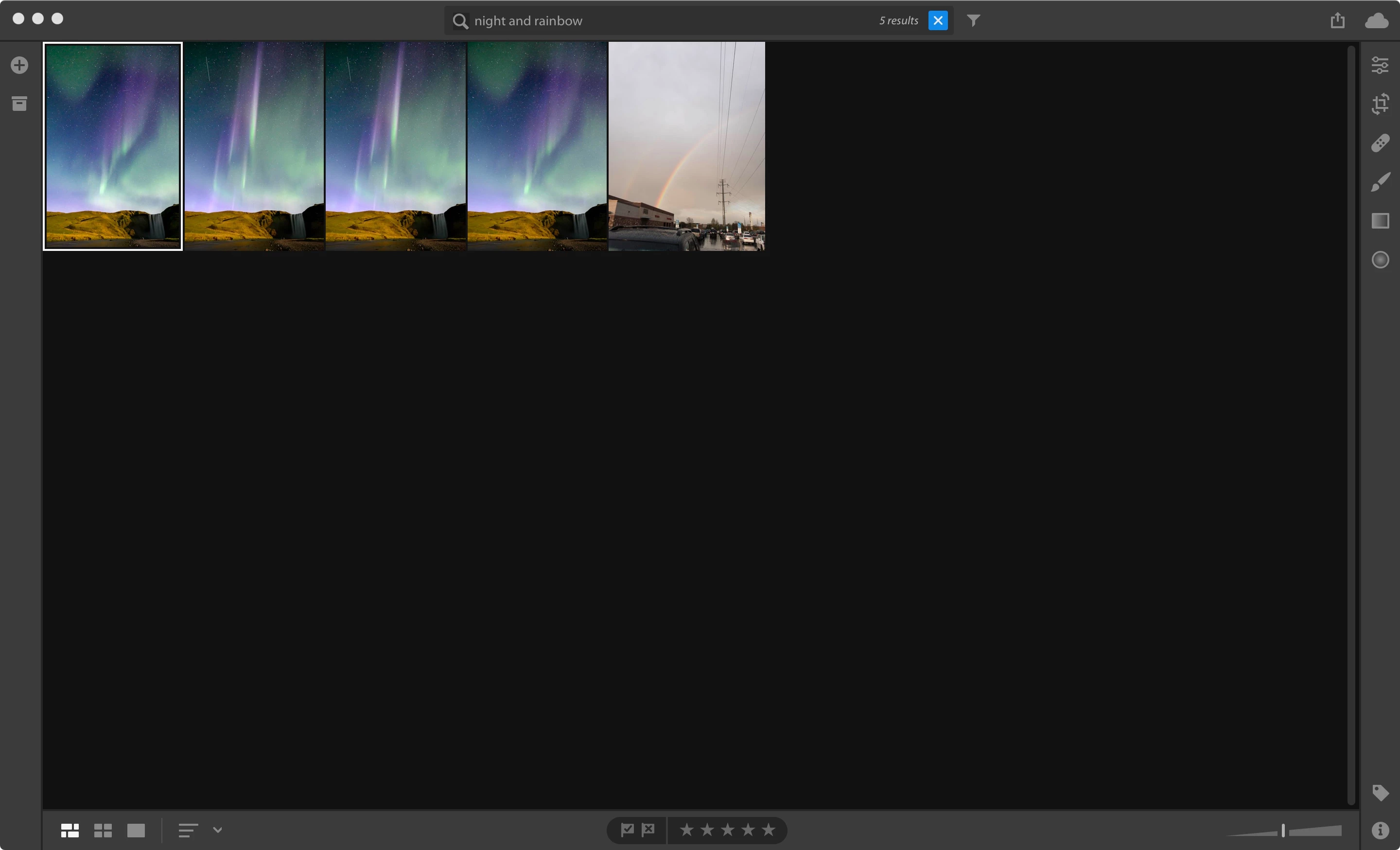

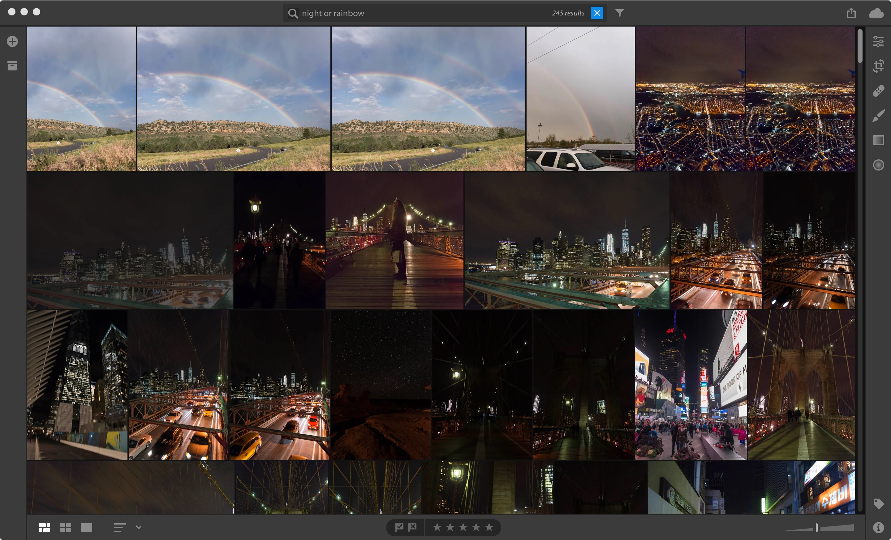

The search in Lightroom CC is run by an artificial intelligence. It understands boolean phrases such as "night and rainbow" being different than "night or rainbow" (see below) and does all kinds of image recognition stuff. I don't know whether the quote thing would work but my guess is that it would only be able to search titles and captions that way.
Interesting that the AI recognizes northern lights as a rainbow.
