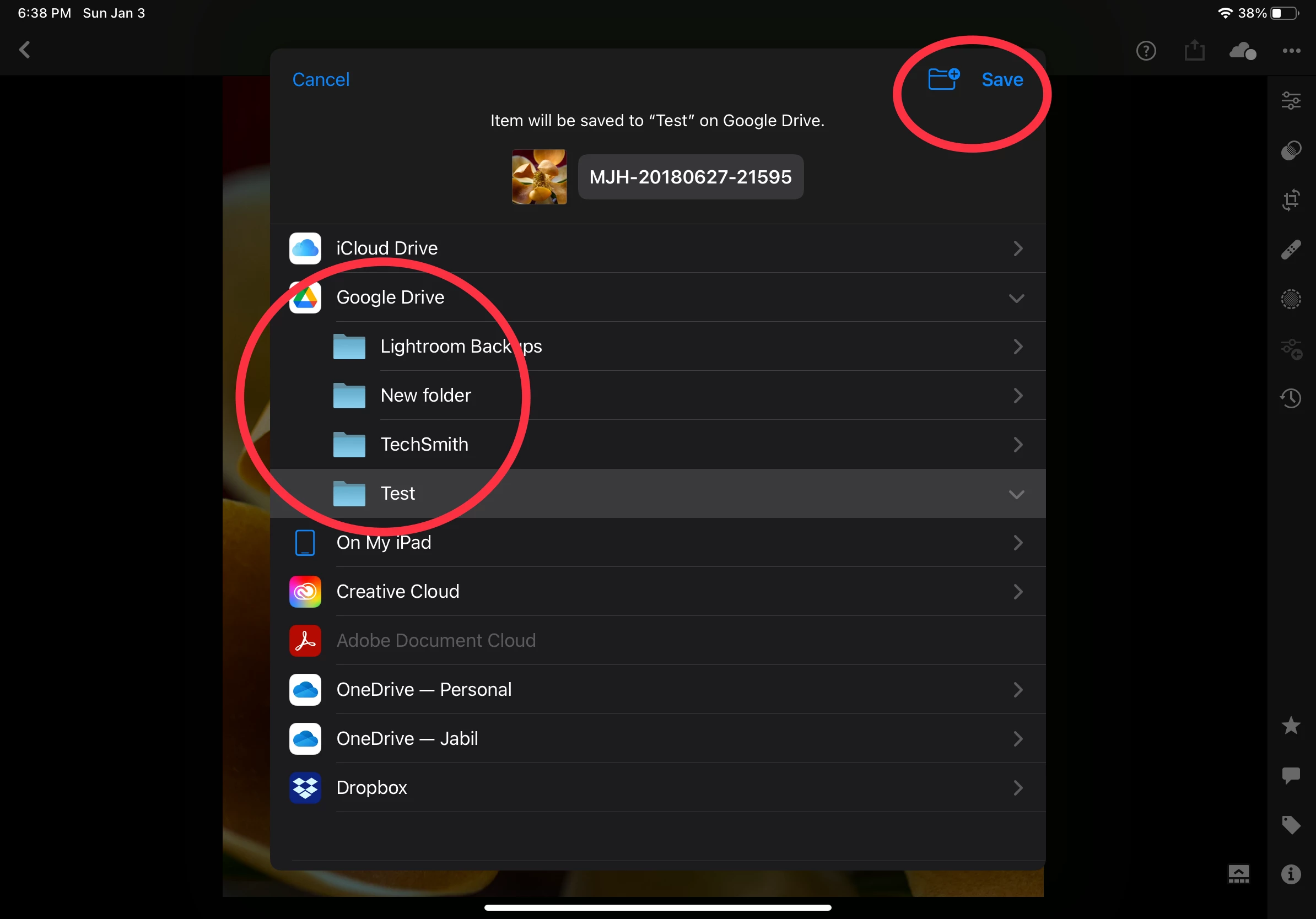

Hi Zuzana,
I just tried myself, and had an issue with Google drive while I was trying to save the screen shots below (same error about the helper application). But I went to the Files app, opened a Google Drive folder and viewed an image, then after that all seemed fine. At any rate, you can rest assured the error about "helper application" is an iOS message and not a Lightroom message (I got my error within the Photos app).
Here is the process I'm using to save a file to Google drive, seems to work OK for me for now:

This question belongs in the Lightroom Mobile forum; I will move it.
If you're having "helper application" issues, I would recommend you open the Files app on iOS and make sure you are currently signed in to Google Drive within the Files app. Sometimes you get signed out, and then the inter-app sharing doesn't work properly.

Hello Michael,
I opened Files app and checked Google drive - I see I am log in, (in Drive app, too)... I am not sure, it is the solution.
After the call with LR support, I resigned in lightroom again, and now there is no option to send any only one photo straight from Lr to G.Drive althought the option/icone to save in google drive is on the list.
