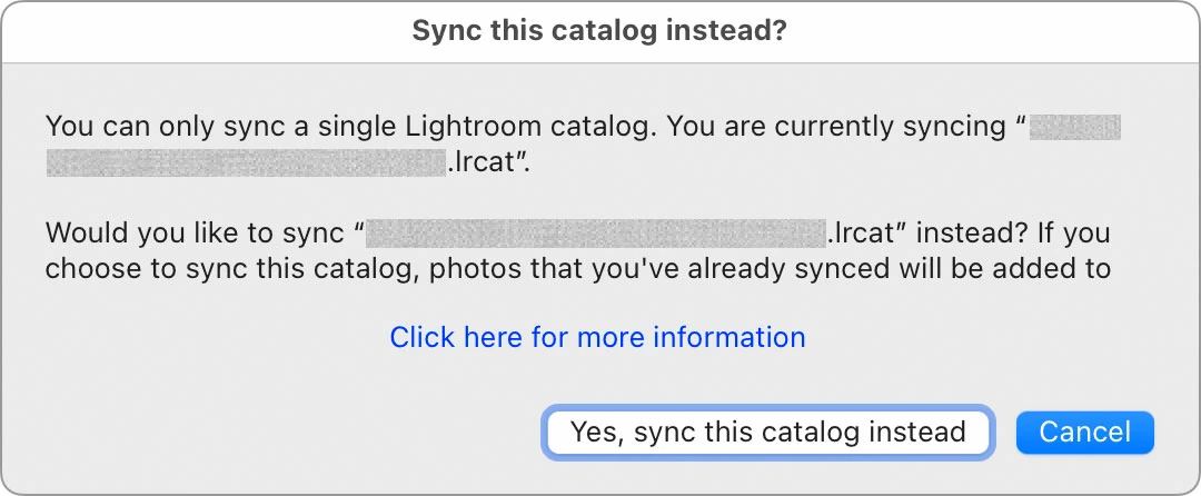

You can try enabling sync from a new catalog. The following alert will appear:
Unfortunately the dialog box design did not anticipate my long catalog names, so it cut off the end of the message. The rest of the words are “…this catalog.” The “Click here for more information” link goes to this web page, which you probably want to review:
Sync a different desktop catalog with Lightroom for mobile
On that page is a note that seems critical for what you’re trying to do:
Note: Since Lightroom syncs only Smart Previews to Lightroom for mobile, for those images that were synced from Lightroom desktop app, Smart previews are downloaded and Originals are mapped if located at the same location from where the photo was first synced.
Notice that last line: “…originals are mapped if located at the same location from where the photo was first synced.” If that means what we hope it does, it might be the relinking that you want, if your originals are still in exactly the same folder hierarchy that they were in when the old Mac died. But I’m not sure because I have never gone through this. (I clicked Cancel when I made the alert above appear.)
