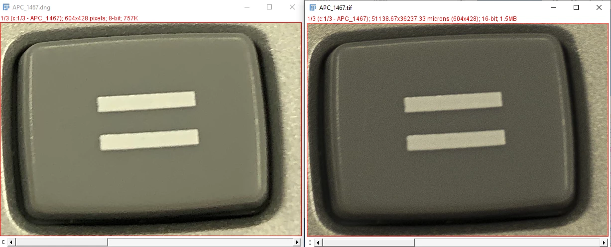

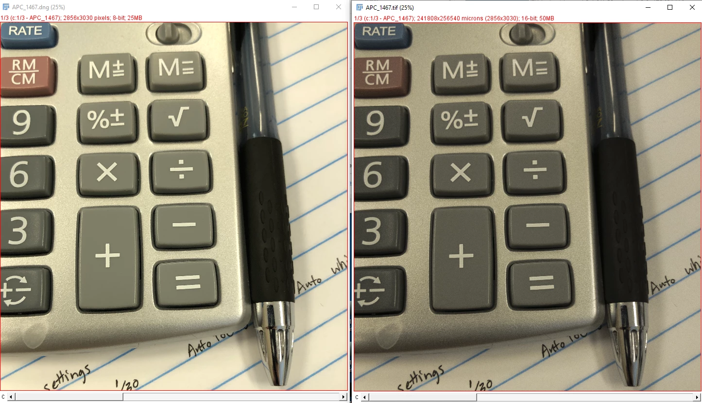

Here are the sample images that I am comparing:
and zoomed in:

I'm only telling you what I believe is happening. If the DNG file contains 8-bit data then you must be using Photoshop Elements instead of Lightroom because DNG files in Lightroom are 16 bit images, and the JPEG preview is an 8-bit image. I have only told you what I understand. Apparently you don't want to accept my explanation, so I will step aside and let you wait for someone else who might have a better explanation.

If you want to truly analyze an image then you want to use software that is fully capable of doing the analysis. An image viewer isn't going to be capable of providing a full analysis of the raw image, and that includes DNG files. You need to use a true raw converter and its tools to extract the information. An image viewer might indicate that it "supports" different raw formats, but in reality it isn't reading the raw image data. It is only reading and interpreting the information that is in the embedded JPEG preview file. And the JPEG preview file isn't going to report the traits of the raw data because it really is a separate file, even though it is embedded within the raw file or the DNG file. So if you want to compare apples to apples then you need to use the right software to do it. It really is that simple and straight forward.

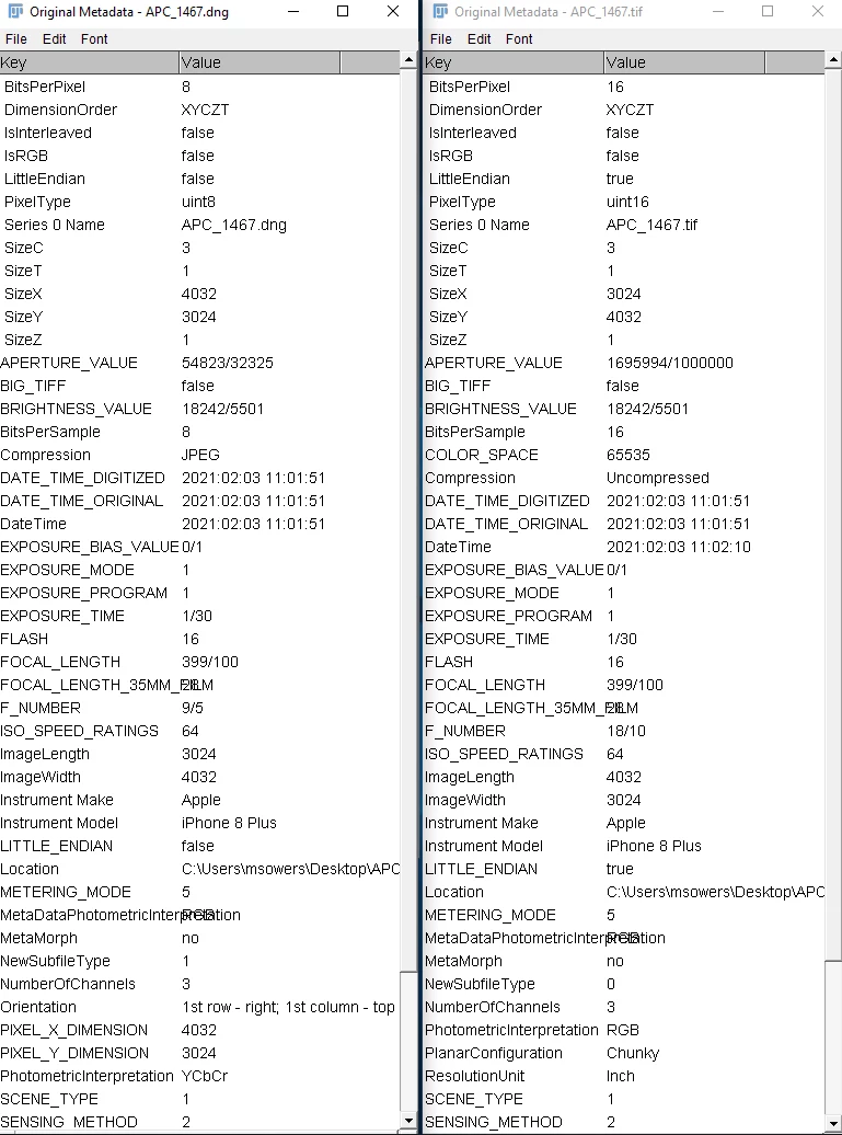

I don't know anything about that software. But that would be my suspicion. Unless the software is actually a raw conversion software, it could "support" the DNG format but only to the extent that it is capable of rendering the embedded JPEG preview. Does that software support native raw formats?

If it is reading the JPEG preview, would it not have obvious artifacts in the images? I can tell a difference between the "DNG" and TIFF images, but the difference does not seem very extreme even when fully zoomed. I know that I am missing data between 8 bit color channels in DNG and 16 bit channels in TIFF, but is the 256 vs 65,536 levels of color the only difference?

First of all, DPI or really PPI (pixels per inch) is basically meaningless. The image dimensions is all that matters. Changing the PPI doesn't change the quality of the image in any sense. Next, what are you using to look at the two different images? If you are not looking at the DNG file with a raw converter then all that is being displayed is the embedded JPEG preview, and that is one explanation for the reduced PPI. Normal image viewers cannot display raw image data, and have to resort to displaying and reporting the characteristics of the embedded JPEG preview. The file size comparison seems about right, in my opinion when considering what I have explained.

Thank you for your response! I am looking at the images in ImageJ (an open source software). DNG import is supported when using a plugin called Bio-Formats.
However, you mentioned that it seems as though the JPEG preview is being read instead of the raw image?

This is the Metadata after import to ImageJ if that helps for comparison.
