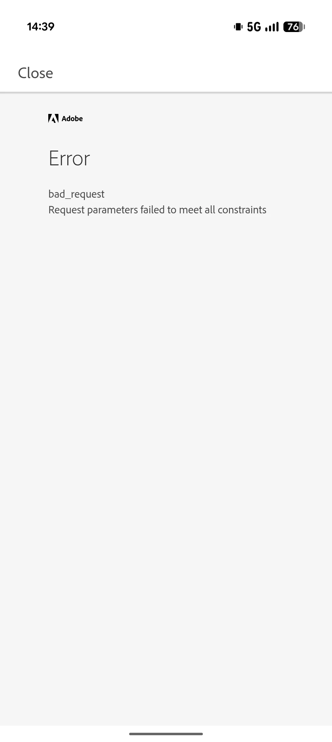

I’ve been struggling with a similar issue on Google Pixel 10a, not with Lightroom, but the Account Access app.
The process is the same - I press the “Continue with Adobe” button and I get redirected into a new window, where I get the same error as you:
bad_request
Request parameters failed to meet all constraints
Now this might be different with Lightroom or with your phone, but I get an internal browser window with a link that’s broken. It looks something like this:
https://ims-na1.adobelogin.com/ims/authorize?client_id=AdobeAccountAccess2&scope=pwdless.register&response_type=code&client_redirect=adobe-accacc%3A%2F%2Fwww.adobe.com%2FsignInDone&locale=en-cz-u-fw-mon-ms-metric-mu-celsius&code_challenge=wKD0LxQXoap4_bwopr4hjopDWdEMIwc3bLqbL-ambHI&code_challenge_method=S256
Now, after trying ALL of the possible methods mentioned in this thread and even browsing through chinese forums speaking about the same issue, I had an idea. I put the above mentioned URL into Claude AI and described the issue.
What Claude gave me instantly is this: The problem is this part of the URL:
Apparently these parameters were the reason I couldn’t access the proper login page. Once I entered the URL without these parameters, I got instantly redirected to the proper page and could log in.
I hope this helps you resolve this issue.

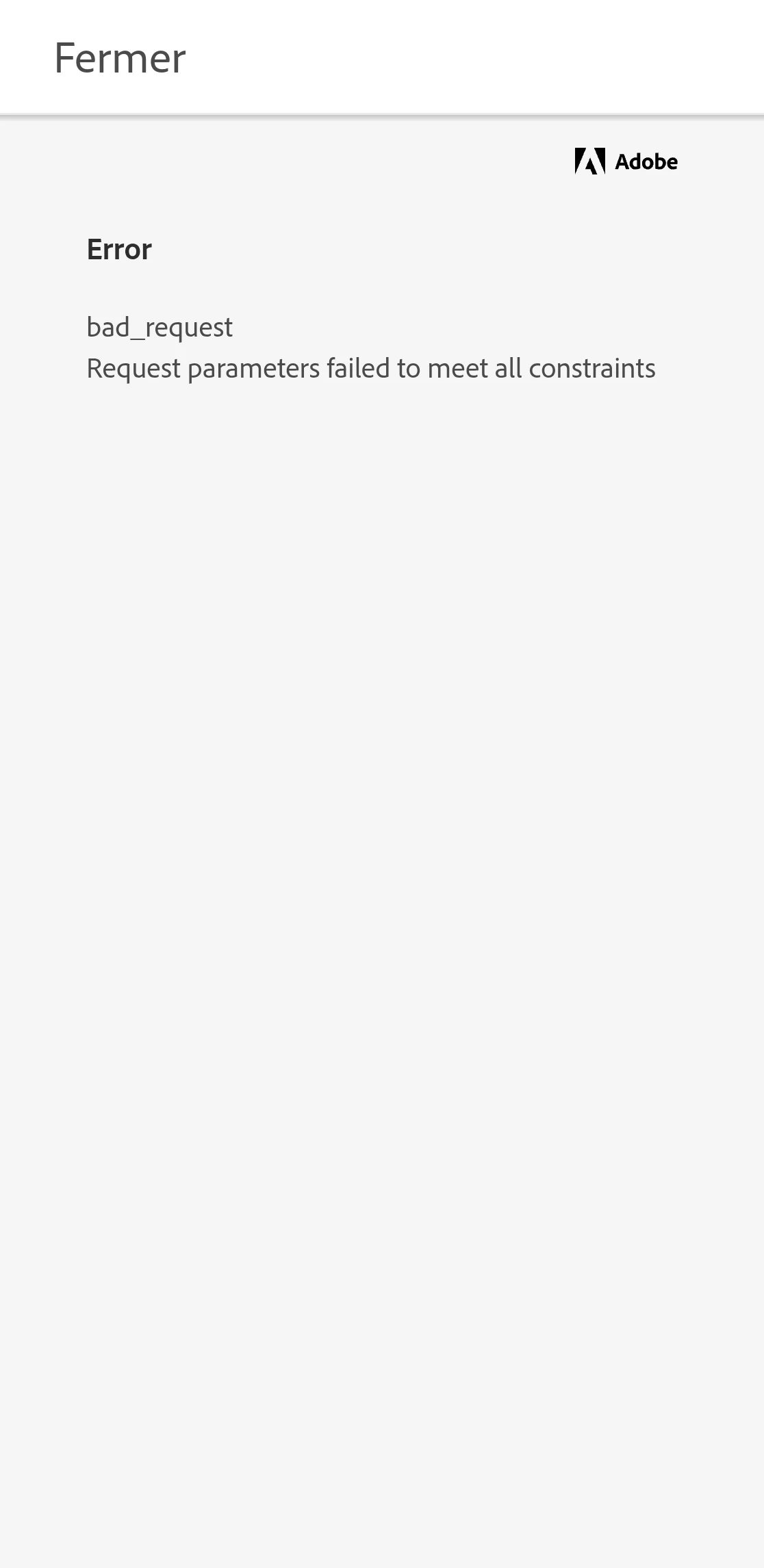

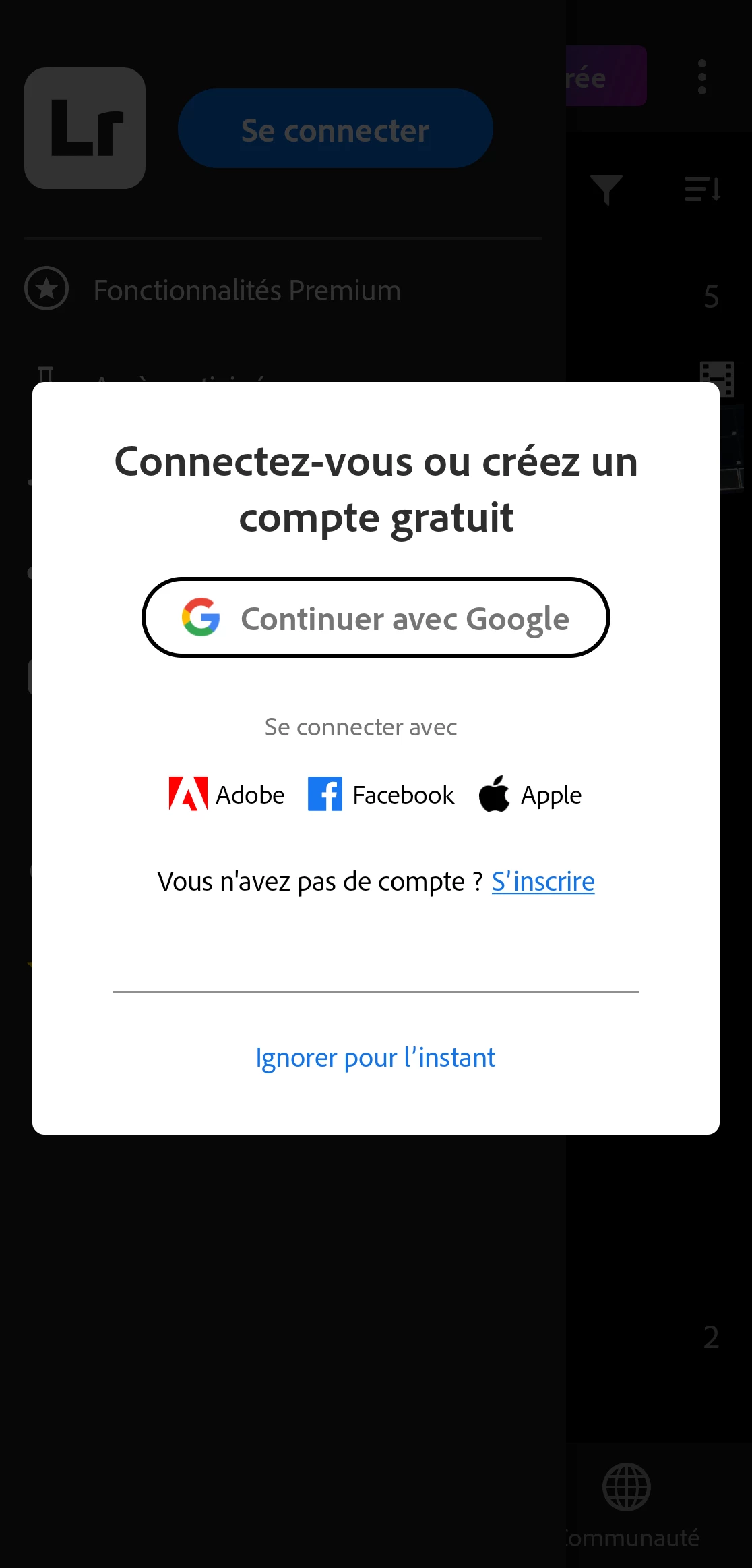

Sep 26, 2026 12:27 PM UTC
Hi ​@Anshul_Saini,
Thanks for your message !
  • My new phone is a Fairphone Gen.6 (the old one was a Fairphone 3+)
  • At the beginning Lightroom was restored from the previous phone. Then uninstalled / reinstalled
  • Screenshot of the exact error page attached.
  • Yes the error appears immediately after selecting “Connecting with Adobe” (other screenshot attached).
Chrome and WebView are fully updated. I tried anyway after a phone reboot, and that’s the same issue.
I already tried using mobile data (wifi disabled), and on different wifi, because I’ve been trying for 1 month, so I tried with my home place wifi, on different wifi at work, etc etc…
I tried “Continue with Google”, or “Connect with Facebook”, and the corresponding page works (but my adobe account isn’t linked with my google or facebook accounts. But the log-in page works in these cases !
