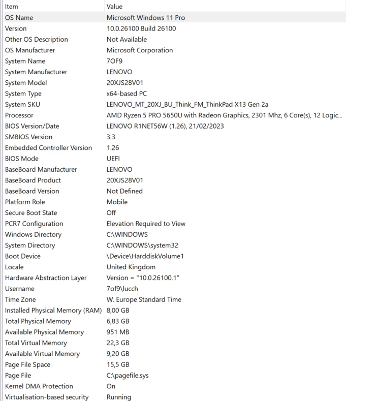

Could you share a few more details about the issue? Does it happen with every photo? Are you on Windows or Mac? If possible, a screenshot showing what happens when you try to use Lens Blur with all Lightroom panels visible would be super helpful.
It would also help to see your System Info. You can find it in Lightroom under Help > System Info. Just copy the info into a text file and attach it to your response, or share it via Google Drive, WeTransfer, or any file-sharing platform you prefer.

hi @Aleke , sadly yes it happened with all the pictures, i'm windows user, as @GoldingD sayid i was using the Lr version instead of LrC but is the same, the difference is that in Lr the checkbox is selected and nothing change but in LrC an error is display. I already try with *.neff and *.jpg pictures, i took some pics with F1.8 and F10 of persosns and objects but is the same in both softwares.

Thanks for sharing this. I'll help you figure this out. In Lightroom's preferences, set the Graphics Performance to Power Saving
As a good starting point, use AMD's auto-detect program to update the GPU Drivers on your machine, follow from step 3: https://adobe.ly/4jQimkB
After updating the GPU drivers, try the steps below and check the results. The GPU info & Logs location on Windows is %APPDATA%\Adobe\CameraRaw. A shortcut to get to this folder on Windows is:
  • Press the Windows + R
  • Enter %APPDATA%\Adobe\CameraRaw
  • Rename the GPU & Logs folder in this directory by adding .old at the end. (GPU.old & Logs.old)
  • Launch Lightroom again.
Let me know how it goes. Thanks!
