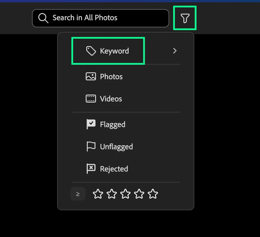

    Hi everyone,
    Thank you for continuing to share your experiences here. I’ve been discussing the feedback in this thread with the Lightroom team, and I want to provide a bit of context on where things stand.
    Search covers quite a few different workflows, and after reviewing the reports here again, it’s clear that not everyone in this thread is experiencing the same problem. We have examples involving keywords, captions, filenames, multiple search terms, and differences between Lightroom Web, Lightroom Desktop, and Lightroom Classic.
    The team is continuing to work on the Lightroom Web search and filtering experience. One change that is already available is a more direct Keyword option in the search/filter interface, so users who want to find photos by an assigned keyword can explicitly perform a keyword-based search rather than relying on the broader contextual/semantic search. Additional search/filter improvements are also being worked on.
    However, I don’t want to assume that the new Keyword option resolves every report in this thread. For example, searching a person’s name stored in a Caption, searching an exact filename, and a Keyword filter returning incomplete results are different workflows and need to be evaluated separately.
    To help me document each case accurately for the product team, if you’re still experiencing a problem, please share one specific example and, ideally, a short screen recording showing:

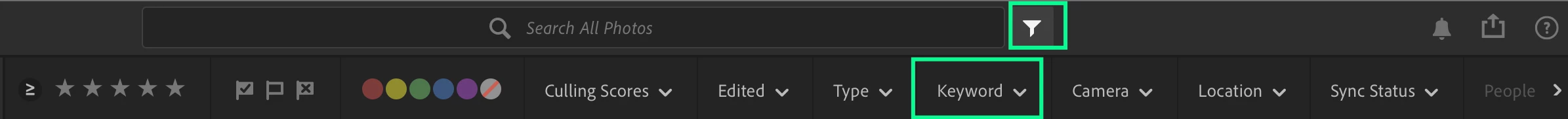

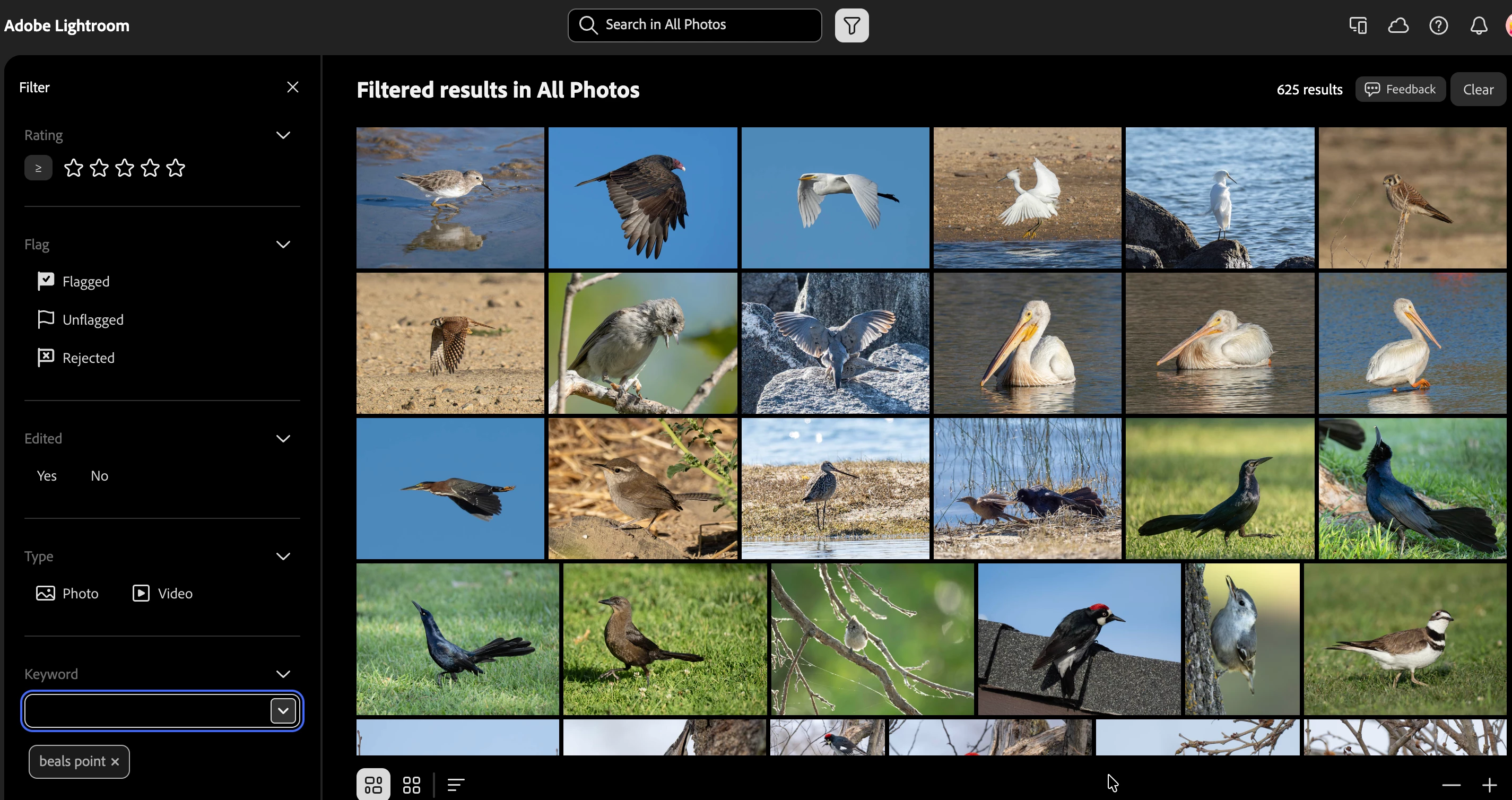

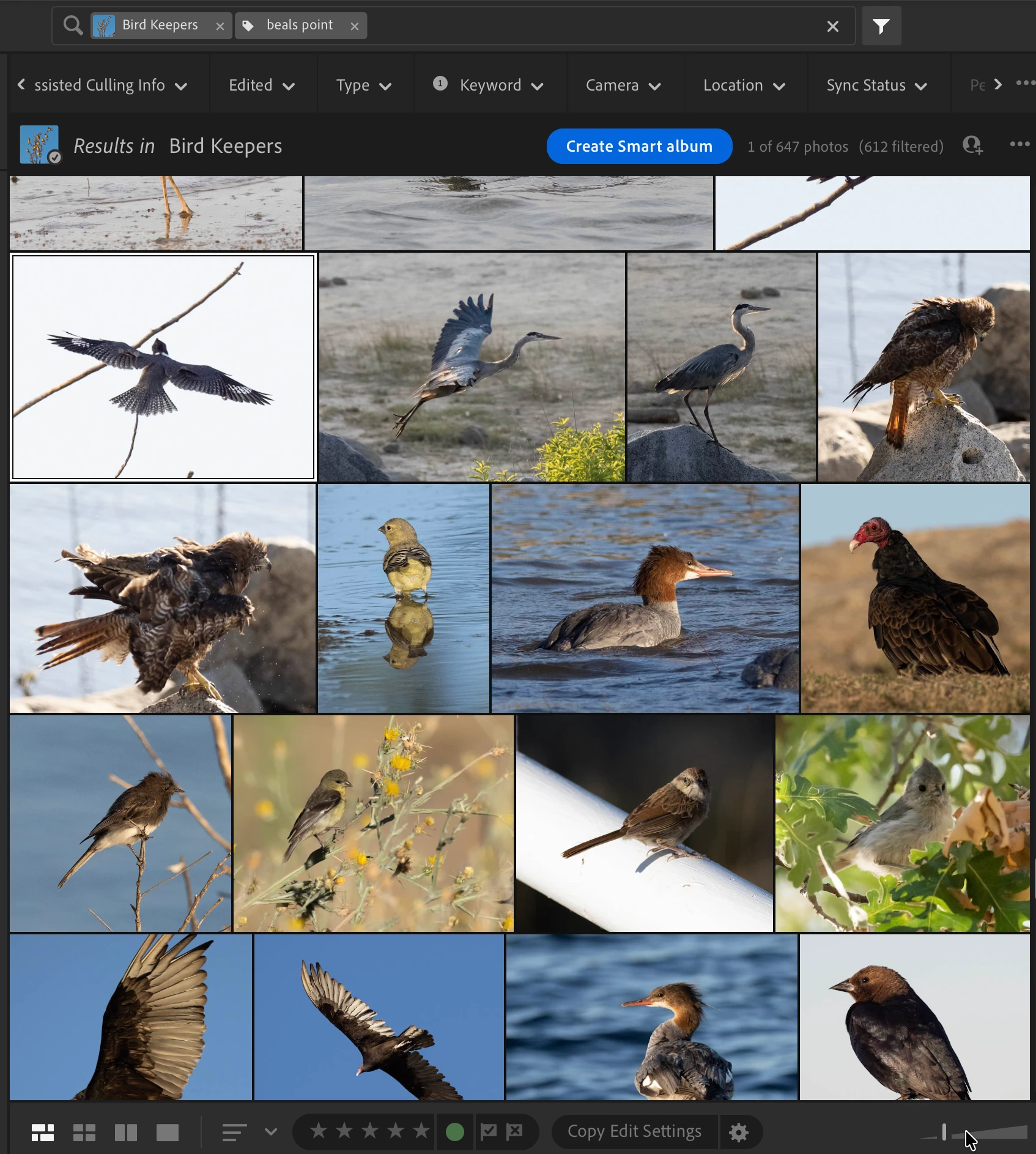

    I am using keywords to filter and the desktop apps for classic and cloud return the correct result (if and only if I use the filter). Web though - I find it’s way off. I take photos of birds and I meticulously tag them all by location as well as species information. Here is just one example of a mismatch which I will post screenshots of. I filter by my keyword “Beals Point” in the desktop app - I get a correct result of 647. I filter by keyword in the web app, and I get 625.
    As an aside - the filter feature on the web is frustrating to use - it seems I have to type the entire keyword and can’t just tab or hit enter to choose it?
    Desktop Filter by keyword “beals point” returns 647
    Web filter by keyword “beals point” returns 625

    Hi @randomnothing,
    Thanks for providing the exact comparison and counts. I’ve shared your “Beals Point” example with the Lightroom team. The team is now looking specifically at inconsistencies where assigned keywords or the resulting photo counts differ between Lightroom Web and Lightroom Desktop.
    Could you please also confirm whether 625 or 647 is the expected total by checking the photos assigned the “Beals Point” keyword? If possible, please identify one or two specific photos that appear in Desktop’s 647 results but are missing from Web’s 625 results.
    That will give us a concrete missing asset to trace rather than only a difference in totals.

    For searches that are intended to be constrained by keywords, the team recommends using the Keyword Filter (funnel icon) rather than relying solely on the natural language search box.

    Thanks for reporting this. For keyword constrained searches, please use the keyword filter by selecting the funnel icon.
